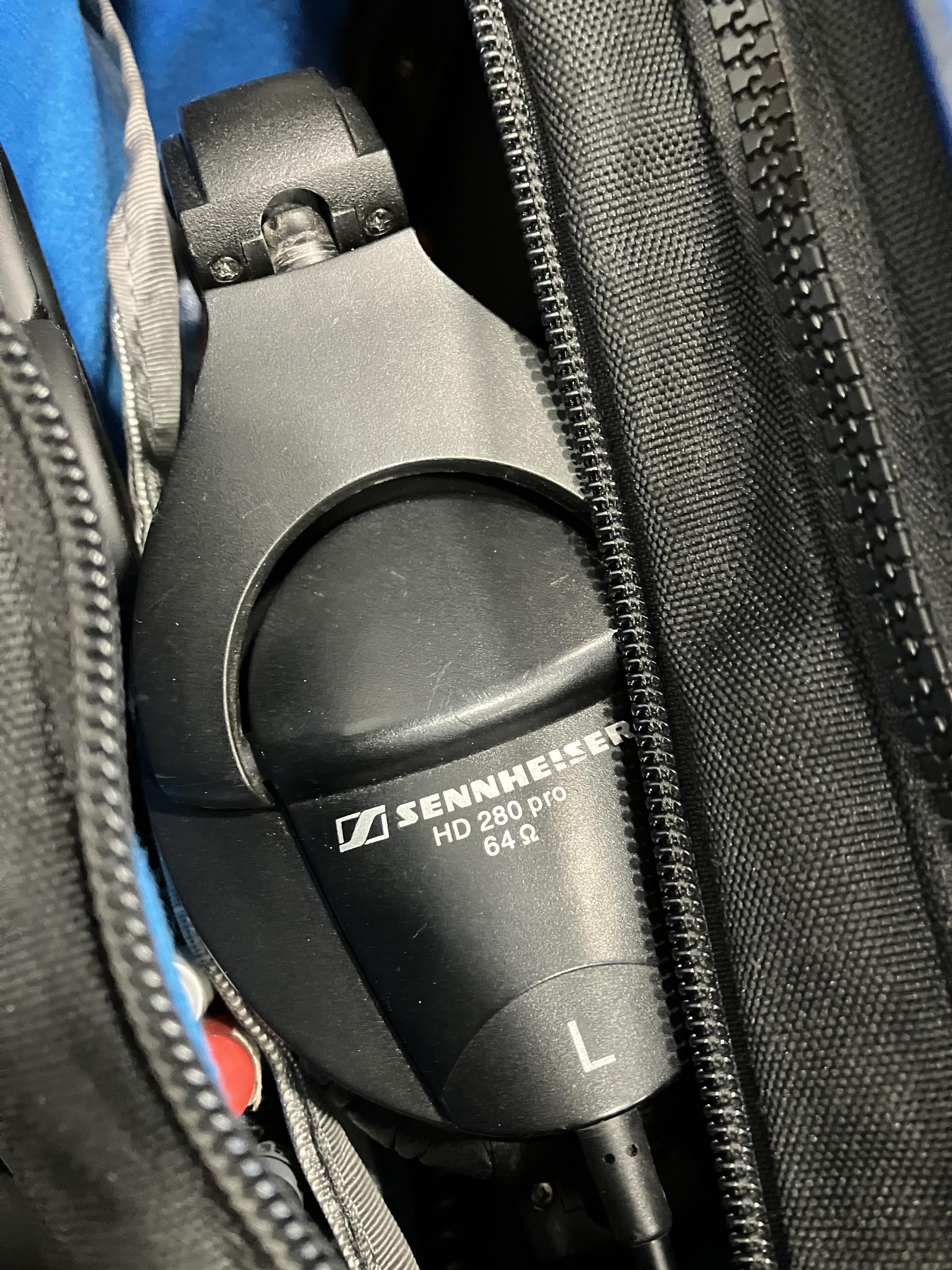

kevcarlson Posted January 23 Report Posted January 23 Can you guys educate me? Maybe @Doc Justice if you're the headphone guy? I've been really happy with Senn. HD 280 pros 64Ω. But I'd like another pair of headphones, and was considering Beyer DT 770--is this considered an upgrade? Some studio guys I know think they are the best. But which [closed back] version should I get? And I thought the higher the Ohms the less noise (if your HP amp can drive it), but I'd like to learn how Ohms affect the signal. Which Ohms should I try to find in headphones? FYI, I use a 688 and 633 for mixer. Also, I don't want to spend more than $199, which I think several of the 770's are right now. Quote

kevcarlson Posted January 23 Report Posted January 23 10 minutes ago, The Documentary Sound Guy said: If you're looking for audio quality, impedance isn't where you should start. It's a consideration for headphone designers, not for mixers, other than making sure your equipment can drive them. Long story short, if you are happy with your HD280s, why change them? Thanks for that really thoughtful comment @The Documentary Sound Guy. And thanks also to @Ontariosound for the response. Both are very helpful. The reason for the change is just to be able to hear more detail and know what I'm capturing so I can deal with it on set. So I'm not starting with just looking at impedance, I just wanted to learn or confirm on that aspect of it. Especially when there are options for that, like with the 770s. My understanding so far is that the higher ohm options have more windings, and tighter drivers and so do result in a better representation but of course you can't use that on low power sources. Maybe phrased another way, if your mixer can drive them, is there any reason not to go with higher ohms--if the audio will be slightly better? Quote
