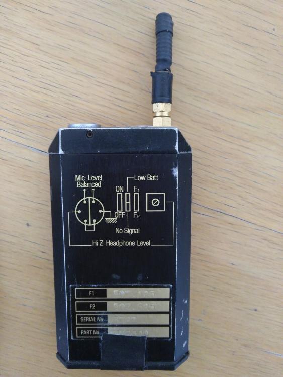

I bought a pair of old Audio RMS 2000 Rx-Tx.
I'm experiencing noise bursts/dropouts (see sound example) as soon as I move 3-4 meters away from the transmitter.
Any ideas what might be causing this?
The frequency range is 507.125/507.625
The antennas look pretty battered, do you think it would help to replace them?
Thanks in advance for any tips!
bests,
Koen

Those are helical antennas and not very efficient..i would if you dont have other whip anntenas cut a couple of 7 inch bits of straight thin wire and without damaging tje sma socket poke wire into socets and do a walk.test if you are getting further than before then  its prob the anntemas..those audio ltd are from the mid nineties pre diversity so getting on now so could be a off tune issue as well..there are two diff freqs make sure and try both..
