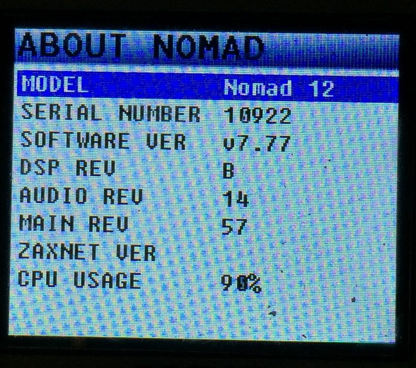

Matthias Richter Posted April 17, 2018 Report Posted April 17, 2018 On my Nomad I want to have 1-8 AES, analog 5&6 and Zaxnet ON. According to the manual I should use setup #13. But with my Nomad (running 7.77) it is missing AES1&2. Only setup with AES 1-8 ON on MY Nomad is #7. But this would be without Zaxnet and no analog IN. Is it my slightly old software? Or just not possible?? Matthias Quote
John Blankenship Posted April 17, 2018 Report Posted April 17, 2018 In your "About Nomad" screen, what are the "Audio Rev" and "Main Rev" numbers? If memory serves, at lest one of these needs to be at, or beyond, a certain version in order for the additional settings to be available. I think it's "Audio Rev" but don't quote me. I did it a long time ago, but if IIRC, it needs to be sent in for this updating. Quote
Matthias Richter Posted April 17, 2018 Author Report Posted April 17, 2018 here is the screen. But what are these version numbers I need to beat? Quote
John Blankenship Posted April 17, 2018 Report Posted April 17, 2018 I'm not near my Nomad right now but will be able to be check my rev #s either today or tomorrow. Someone else may weigh in sooner. Also, you could contact Zax tech support and they'd be able to tell you. Quote
Matthias Richter Posted April 17, 2018 Author Report Posted April 17, 2018 Thanks John! Have contacted ZaxSupport already - still waiting for an answer. Quote
pindrop Posted April 17, 2018 Report Posted April 17, 2018 Think you might need Audio Rev 15 From JW Sound discussion in April 2015 "7.29P Apr 8 fixed blue trim dot on card tracks being shown when track is not an ISO track (sometimes) fixed loud noises when changing Input Configure mode support for new "Audio Rev 15" hardware PLD modification (see the About screen) which allows all AES inputs to work with IFB turned on:" Quote
Matthias Richter Posted April 18, 2018 Author Report Posted April 18, 2018 Got a reply from Zaxsupp. Yes I will need audio rev 15. Mist ... Quote
