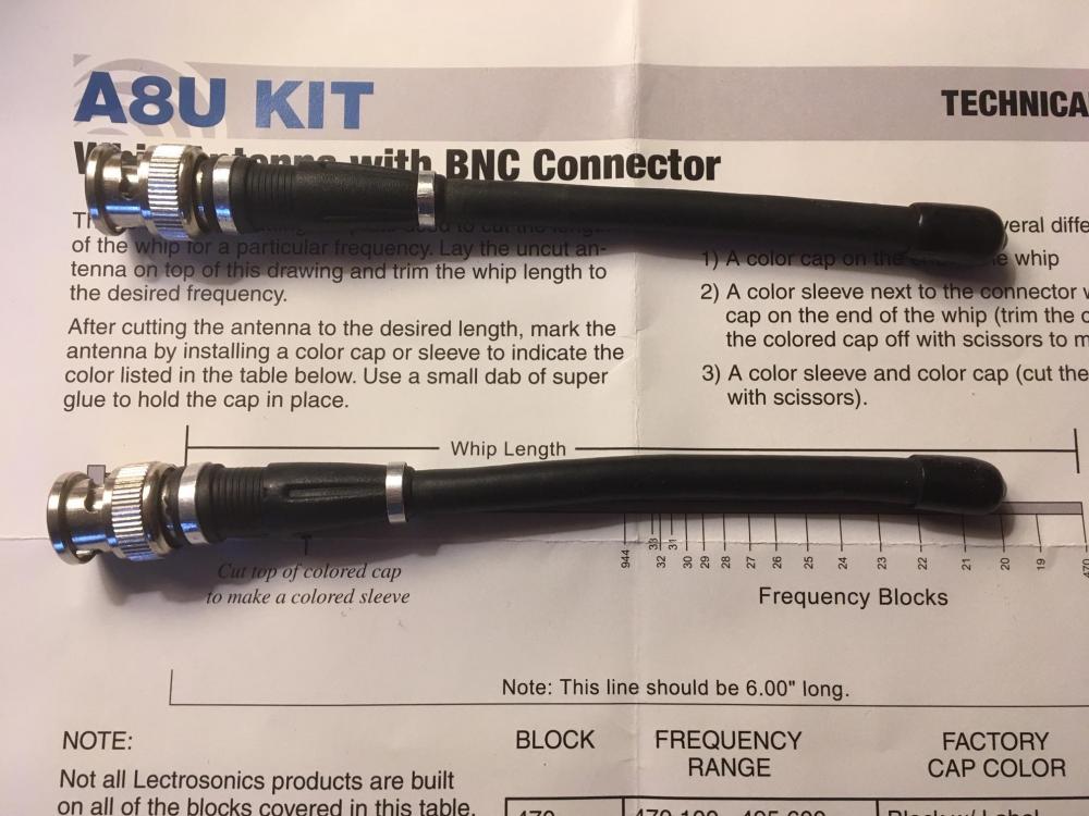

sinnlicht Posted January 5, 2019 Report Posted January 5, 2019 Any help in identifying these antenna would be much appreciated. Thanks RL Quote
cstauffer Posted January 5, 2019 Report Posted January 5, 2019 Those are the exact antennas that came with my old Lectro 195 receivers if that is what you are asking. Should work with any Lectro receiver of the big ol black box type ie. 211s, or 411's as long as the length is matched to the receivers block. Would likely work regardless of the block, maybe just not as well. CRAIG Quote
sinnlicht Posted January 13, 2019 Author Report Posted January 13, 2019 Hi Craig, when I called Lectro they could not identify them by my description other than being VHF antennas unsuitable for UHF receivers. Could you confirm that you think that they can be used successfully with 205D/201D receivers? Thanks for your help. RL Quote
jason porter Posted January 13, 2019 Report Posted January 13, 2019 Those are UHF antennas tuned for Block 20. The picture has all the information you need. Quote
afewmoreyears Posted January 13, 2019 Report Posted January 13, 2019 Best way is to simply throw them on, fire up a wireless set on one one of your 205Ds, 411s, or anything else and test the range and function... it will either work well, work OK, work poorly or ...not at all.. Easy and a fast way to your answer... unless you have no units to test on.. Agree with CStauffer...those were from the old 190-195 units I believe.. Quote
Philip Perkins Posted January 13, 2019 Report Posted January 13, 2019 I recall those silver rings being on the antennas I had for my 195s..... Quote
Rachel Cameron Posted January 21, 2019 Report Posted January 21, 2019 Late vote for UCR 195. Looks like my old 195's, complete with that silver ring. Block 20 like Jason says. Quote
