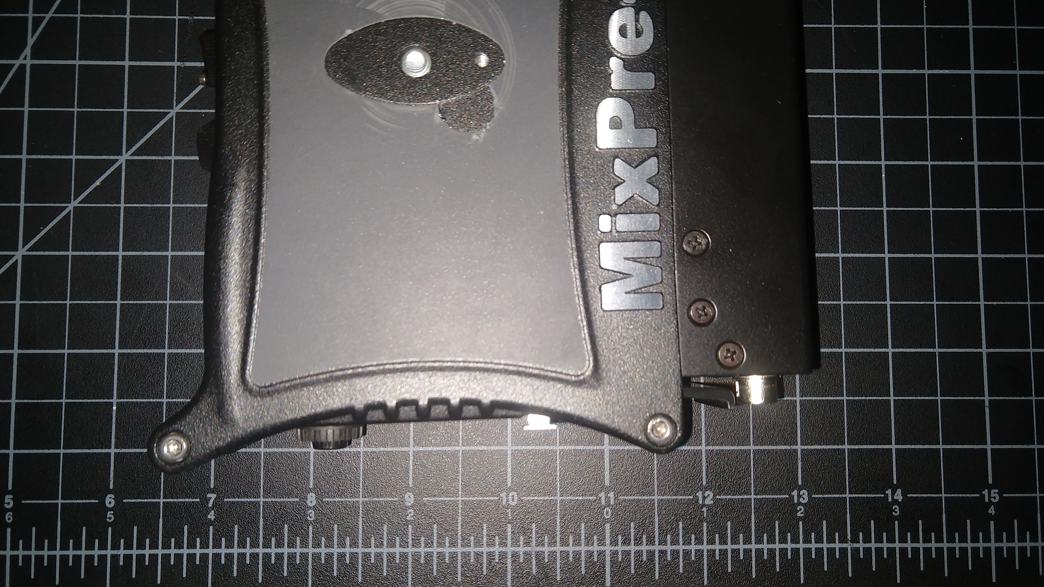

TomBoisseau Posted January 2, 2021 Author Report Posted January 2, 2021 Thanks for your input Neil. How well "recessed" is the Hirose connector on the Cable Techniques unit? It appears (from photos) that the "sideway" recess is greater with the Sound Devices adapter, which might possibly mean less strain on the connection when using in a bag and when running about. Tom Quote
Rick Reineke Posted January 2, 2021 Report Posted January 2, 2021 It 'appears', by the photos, the SD adapter is a lower profile module. Quote
Erin Bliss Posted January 2, 2021 Report Posted January 2, 2021 Here's a detail shot of the inset on the hirose connector on the mx-powersled mounted to a mixpre-3 II. Grid lines are every half-inch. Quote
TomBoisseau Posted January 3, 2021 Author Report Posted January 3, 2021 Thank you Neil. That's very helpful. Tom Quote
