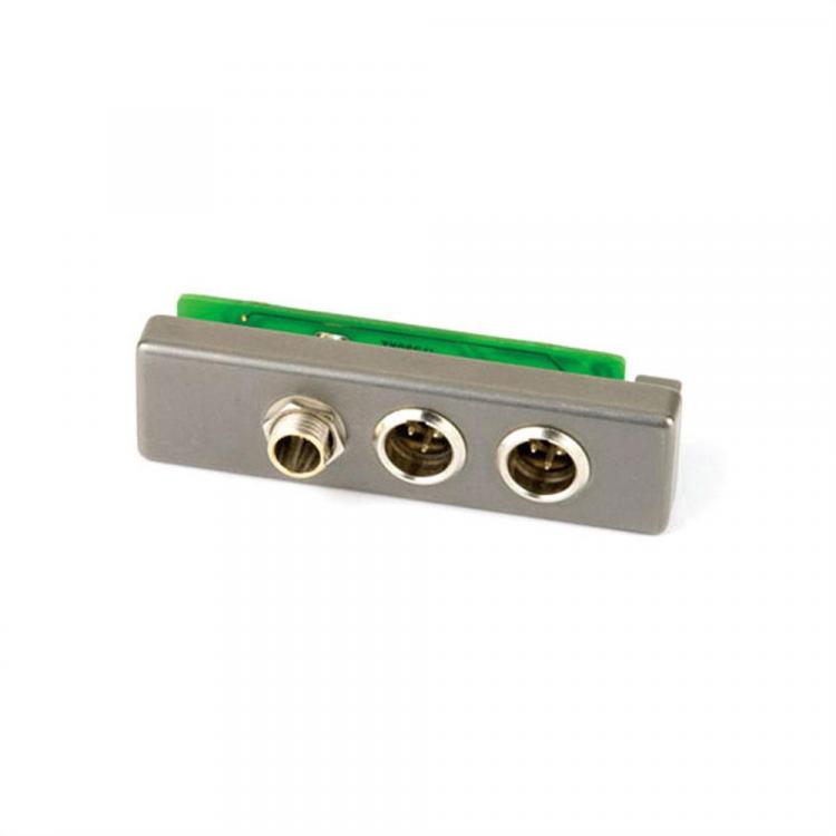

JavierCarles Posted February 4, 2022 Report Posted February 4, 2022 Hi all, I've just upgraded to Lectro, and I have the SRB rx with SREXT bottom plate, which means I can power up the RX with 6-18VDC I have a Talentcell recharg battery 12V that works fine with my F8, but for some reason it doesn't power up the receiver... I don't understand why. I have the right cable, since I've just bought it via pinknoise (DC lock for Lectro to DC) Any power solutions for this? It can be DC or 4-pin hirose, since I have that cable too. Thanks a lot Quote
Jim Rillie Posted February 4, 2022 Report Posted February 4, 2022 Check your power cables used for the SRB for continuity and polarity. Quote
JavierCarles Posted February 4, 2022 Author Report Posted February 4, 2022 16 minutes ago, Jim Rillie said: Check your power cables used for the SRB for continuity and polarity. The exact cable is this one --> https://www.pinknoise-systems.co.uk/sound-guys-solutions-power-cables-for-lectrosonics-various-connections.html Lectro DC Jack to MD-6 Locking Jack Quote
LoganSound Posted February 4, 2022 Report Posted February 4, 2022 Do you have the TalentCell that also has the yellow 9V port? I use that reliably with my SRb, with what I believe is a pretty normal DC cable Quote
Freeheel Posted February 5, 2022 Report Posted February 5, 2022 Check to see if the coax barrel connector going into the Lectro baseplateis the right size. Perhaps you received a 2.5mm barrel instead of a 2.1- it would be easy to make a mistake and ship you the wrong cable, as both barrels are similar on the outside... Cheers, Brent Calkin Quote
