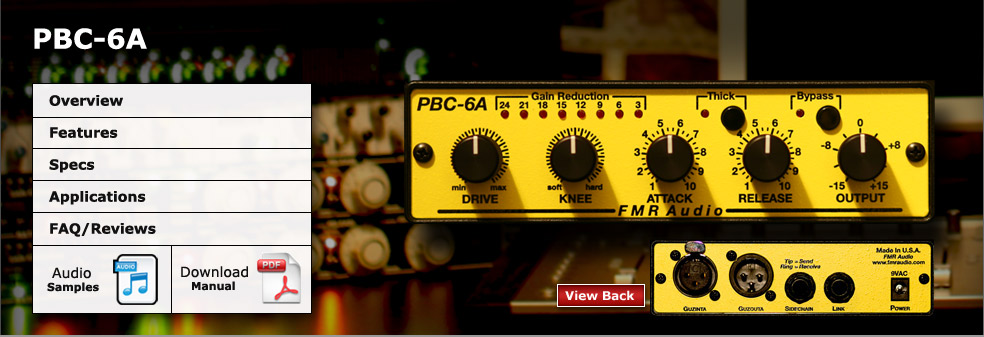

studiomprd Posted August 16, 2010 Report Posted August 16, 2010 which brings us more to the subject of using a little bit of compression on the mix... of course there are very few quality compressors available that run off of DC, which is an issue for some folks and situations. but as Paul indicates, limiting is supposed to be a last resort, brick wall sort of protection... so what our niche market is missing is a small, high quality, great sounding compressor, that runs off of 12VDC; single channel units, perhaps, with capability for linking... Quote

Tom Visser Posted August 16, 2010 Report Posted August 16, 2010 which brings us more to the subject of using a little bit of compression on the mix... of course there are very few quality compressors available that run off of DC, which is an issue for some folks and situations. but as Paul indicates, limiting is supposed to be a last resort, brick wall sort of protection... so what our niche market is missing is a small, high quality, great sounding compressor, that runs off of 12VDC; single channel units, perhaps, with capability for linking... One of the best of the best (12VDC power!)... http://rupertneve.com/products/portico-5043/ Not DC powered, but uses a relatively small wall wart and more economically priced (available soon)... http://www.fmraudio.com/pbc.htm Quote
maplecap Posted August 16, 2010 Report Posted August 16, 2010 which brings us more to the subject of using a little bit of compression on the mix... of course there are very few quality compressors available that run off of DC, which is an issue for some folks and situations. Tom posted two, including one from FMR Audio. I was going to post the FMR RNC1773 "Really Nice Compressor". It's been around for a long time, is inexpensive, and highly regarded as a great sounding budget compressor in the music recording world. http://www.fmraudio.com/rnc.htm Quote
studiomprd Posted August 16, 2010 Report Posted August 16, 2010 fmr audio's RNC and other gear has a great reputation! the new product PBC-6a has a new twist on over easy thresholds... Audio Developments used to make a really fine unit... Quote
Tom Visser Posted August 16, 2010 Report Posted August 16, 2010 Tom posted two, including one from FMR Audio. I was going to post the FMR RNC1773 "Really Nice Compressor". It's been around for a long time, is inexpensive, and highly regarded as a great sounding budget compressor in the music recording world. http://www.fmraudio.com/rnc.htm Absolutely great unit, I was hesitant to mention it to this group, though, because it lack balanced inputs, as it is typically wired into a console's inserts. Quote
