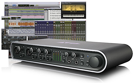

Dre Rivera Posted September 19, 2010 Report Posted September 19, 2010 8x8 I/O http://www.avid.com/US/products/Pro-Tools-Mbox-Pro Quote
Marc Wielage Posted September 20, 2010 Report Posted September 20, 2010 I'm bummed-out that it doesn't have 8 balanced inputs, plus it puts two of the XLRs on the front panel. The Motu Traveller makes a lot more sense to me. They both cost about the same -- $749 street price. --Marc W. Quote
Dre Rivera Posted September 20, 2010 Author Report Posted September 20, 2010 That's exactly what I wished it had, all balanced inputs. Quote

hemmerlinj Posted September 20, 2010 Report Posted September 20, 2010 I beleive all of the inputs are balanced except the set of RCA's which might be for SPDIF. They're just not all XLR's. They can't advertise it as a professional quality interface and not use balanced connections. Quote

soundtrane Posted September 20, 2010 Report Posted September 20, 2010 From the Digidesign website: Hardware configuration: 8 x 8 simultaneous channels of I/O 4 mic inputs with 48 V phantom power and high pass filter (2 XLR/DI combo, 2 XLR) 4 1/4" TRS line inputs 2 unbalanced Alt line inputs (2 RCA, 1 mini 1/8â€) 6 1/4" TRS balanced line outputs 2 discrete 1/4†stereo headphone outputs with separate volume controls Stereo S/PDIF digital I/O 1 MIDI input, 1 MIDI output Word clock I/O Monitor control section with Mono, Mute, Dim, Alt Source, and Speaker A/B/C switching controls Dedicated monitor volume knob Quote

Marc Wielage Posted September 21, 2010 Report Posted September 21, 2010 From what I see of the specs and the back panel, only inputs 1-4 are balanced. All the other inputs are either unbalanced or the S/PDIF digital in. In other words, they're kind of being dodgy with calling it an "8-input" device. Technically, it is, but not like the Motu Traveller with 8 balanced analog inputs. Pro Tools still will only work with Avid/Digi hardware. I'm sure Metacorder and Boom Recorder will work with the MBox Pro, but for the same money, the Traveller makes more sense for location sound. --Marc W. Quote
Jeff Wexler Posted September 21, 2010 Report Posted September 21, 2010 From what I see of the specs and the back panel, only inputs 1-4 are balanced. All the other inputs are either unbalanced or the S/PDIF digital in. In other words, they're kind of being dodgy with calling it an "8-input" device. Technically, it is, but not like the Motu Traveller with 8 balanced analog inputs. --Marc W. You have to read the spec carefully, you can't just look at the picture. When it states "4 1/4" TRS Line Inputs" and "6 1/4" TRS Line Outputs" I believe the "TRS" (Tip-Ring-Sleeve) means that these are most likely BALANCED I/O. It is possible they are fudging on this but I don't think so. - Jeff Wexler Quote
BudRaymond Posted September 24, 2010 Report Posted September 24, 2010 It is 8 balanced inputs. Four are XLR that have phantom power for mic level inputs, and four are line level TRS (Balanced) inputs. Quote

Marc Wielage Posted September 24, 2010 Report Posted September 24, 2010 It is 8 balanced inputs. Four are XLR that have phantom power for mic level inputs, and four are line level TRS (Balanced) inputs. Unless I read the back panel wrong, both sets of input jacks are labeled 1-4, and the front knobs have "front/rear" switches. If the back panel TRS line jacks were for channels 5-8, you'd think they'd be identified that way. I'll see if I can get the manual and will see if we can figure this out. But this also parallels my past experience with previous MBoxes. I'd really love to be wrong about this -- it'd be great if we had 4 mike/line inputs and 4 separate line-only inputs. But given that 5-6 appear to be unbalanced ins, and 7/8 seems to be occupied by an S/PDIF digital input, I'm skeptical. --Marc W. Quote
Jim Gilchrist Posted September 24, 2010 Report Posted September 24, 2010 There are 4 balanced mic/line inputs. 1 & 2 are also DI inputs. Front panel switches select between the DI/mic connectors on the front panel and the TRS line level connectors for inputs 1 & 2 on the back panel. 3 & 4 work the same way via front panel switches, but all the connectors are on the back panel. The line level connectors are switch selectable in pairs between +4 and -10 via switches on the rear panel as well. Inputs 5/6 are unbalanced via RCAs or a 3.5 mm TRS connector. It appears that inputs 7/8 are via the SPDIF I/O included in the DB15 connector on the rear that also allows access to MIDI I/O and word clock I/O. The included adaptor appears to be identical to one that came with an M Audio interface I purchased a couple of years ago. Too short to do anything but make using the device harder and of marginal build quality. The manual is here if you are interested. Best regards, Jim Quote
Marc Wielage Posted September 25, 2010 Report Posted September 25, 2010 Yeah, that's what I thought. So it does not appear to have 8 simultaneous balanced inputs. Given its intended audience (home studios, Pro Tools LE users, etc.), I understand why they did this, but it still woulda been nice... --Marc W. Quote
