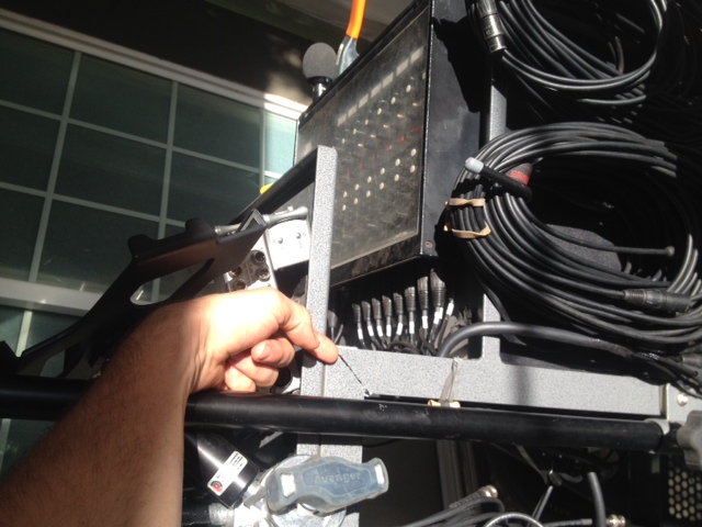

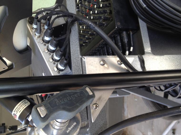

I ended up going to Burbank Auto Doctor. I usually use Audio Department for cart modifications and they've been awesome, but I needed the project turned around on a weekend. Instead of welding it, the Jason at Burbank Auto Doctor recomended reinforcing both handles with a custom cut steal joint because he felt that the break would reappear. They did a nice job and I am happy and everything is functioning well. I'm going to add some wheels on the handles to help ease the strain when I load into the back when I can find the right set. Before I was using a sound blanked that slid on the plastic flooring of my Element, and that worked for around 3 years. I had always meant to add wheels, I just never got around to it because the sound blanket worked so well. Here are some photos of the cart..a work in progress, like all of them. I do not understand why photos are sideways...
yeah, the only problem is that I put the cart on it's back in my Honda Element, so it has to be able to take the weight, which it does usually. Then I was in a hurrying to load out at the end of a long day and when the cart had trouble sliding in, I muscled it..and it broke. Serves me right. Mirror, I'm in Los Angeles. I have some good suggestions from a bunch of people on the 695 Facebook page.
Sorry about the photo being sideways, I'm not sure how to edit that
