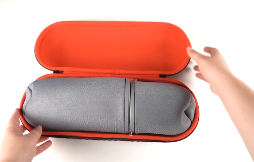

Roland Harris Posted October 18, 2022 Report Posted October 18, 2022 7 hours ago, Spin360 said: Did anybody hear back from Rycote? For me there has been total silence since Timo has gone and I'm unsure if that is going to change... Edit: I literally just got a promising email! Me too, this morning! The attached letter with the email says the new kits will include: · 2 New 3D-Tex Socks · 1 New Swivel Arm – For the Suspension · 1 New Digital Cable Cheers, Roland Quote
Spin360 Posted October 18, 2022 Report Posted October 18, 2022 Also got the instructional videos. Can't say I'm happy with what it looks like. Maybe it looks better in real life, but if the performance is better with he upgrade then that' shall be enough for me. Still, it looks like a grey sausage lmao Quote
