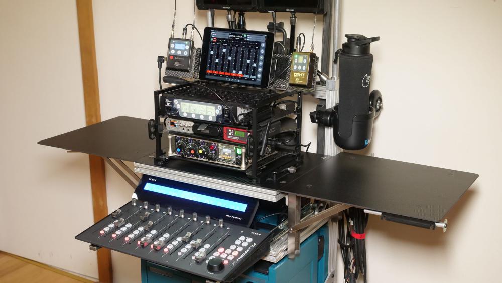

KenMartini Posted March 4, 2023 Report Posted March 4, 2023 I am using it with an 833. I power it and the motorized faders work great. Having the screen is a must. Quote
Fred Salles Posted March 5, 2023 Report Posted March 5, 2023 (edited) 23 hours ago, KenMartini said: I power it and the motorized faders work great. Hello, I guess the motorized faders are power hungry, but there must be just a peak of power draw when you change bank I suppose. You say you power it, do you mean from external dedicated battery Or the same battery as the rest from your power distributor? Can you tell us more about the power consumption of it. Thanks edit: I just saw your post about your cart so one big PSC battery (very nice by the way 👍🏾) Edited March 5, 2023 by Fred Salles Quote
