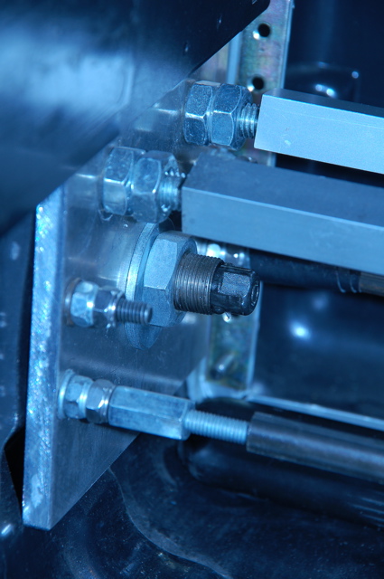

Matthias Richter Posted November 25, 2010 Report Posted November 25, 2010 Is there any better approach to putting SKB cases on wheels? I want to try a case-based cart for a number of reasons but I'm hoping I don't have to make a frame from scratch (looks like that may be the only way). I'm pretty familiar with all the examples in Jeff's gallery. I've been using modified upright PSC cart for years and I like the bicycle tires on it for their easy rolling. I guess I'll go in that direction for wheels on a case cart. Bob. you might wanna check out this old thread on my SKB cart with no extra frame but attached bicycle wheels: http://jwsound.net/SMF/index.php?topic=1488.msg9760#msg9760 there are some more pics on my website: http://www.schallrichter.de/soundcart.html balance is brilliant and I can separate the two cases in a minute. Best, matthias Quote
Jeff Wexler Posted November 26, 2010 Report Posted November 26, 2010 I had forgotten what a nice cart Matthias Richter has done (and pleased to know that the Discussion Group is such a great archive of information and images). I particularly like the way Matthias did the large wheels directly to the case --- properly engineered this makes for no need for a frame/base for the case-cart. If I were to do a case based cart, that is the way I would do it. - Jeff Wexler Quote

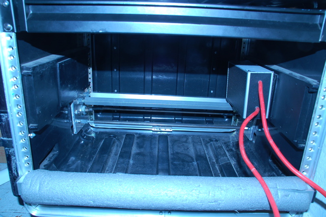

Matthias Richter Posted November 26, 2010 Report Posted November 26, 2010 I had forgotten what a nice cart Matthias Richter has done (and pleased to know that the Discussion Group is such a great archive of information and images). I particularly like the way Matthias did the large wheels directly to the case --- properly engineered this makes for no need for a frame/base for the case-cart. If I were to do a case based cart, that is the way I would do it. - Jeff Wexler thanks for the flowers Jeff! I have done some minor improvements: the plate inside the lower case has been replaced by a bigger one, the top two poles too. Just feels safer. the front door of the top case works as my laptop table now. Table folds into the door, door can be taken off completely if needed, door is lid by a led stripe, laptop can be hooked up with the new m-audio firewire interface (playback, recording isos, backup system) Cooper mixer got his own led now to have better view in side the case where the gain pots are little x-mini loudspeaker sits inside the cart and is powered by a 12V-USB adapter Matthias Quote
