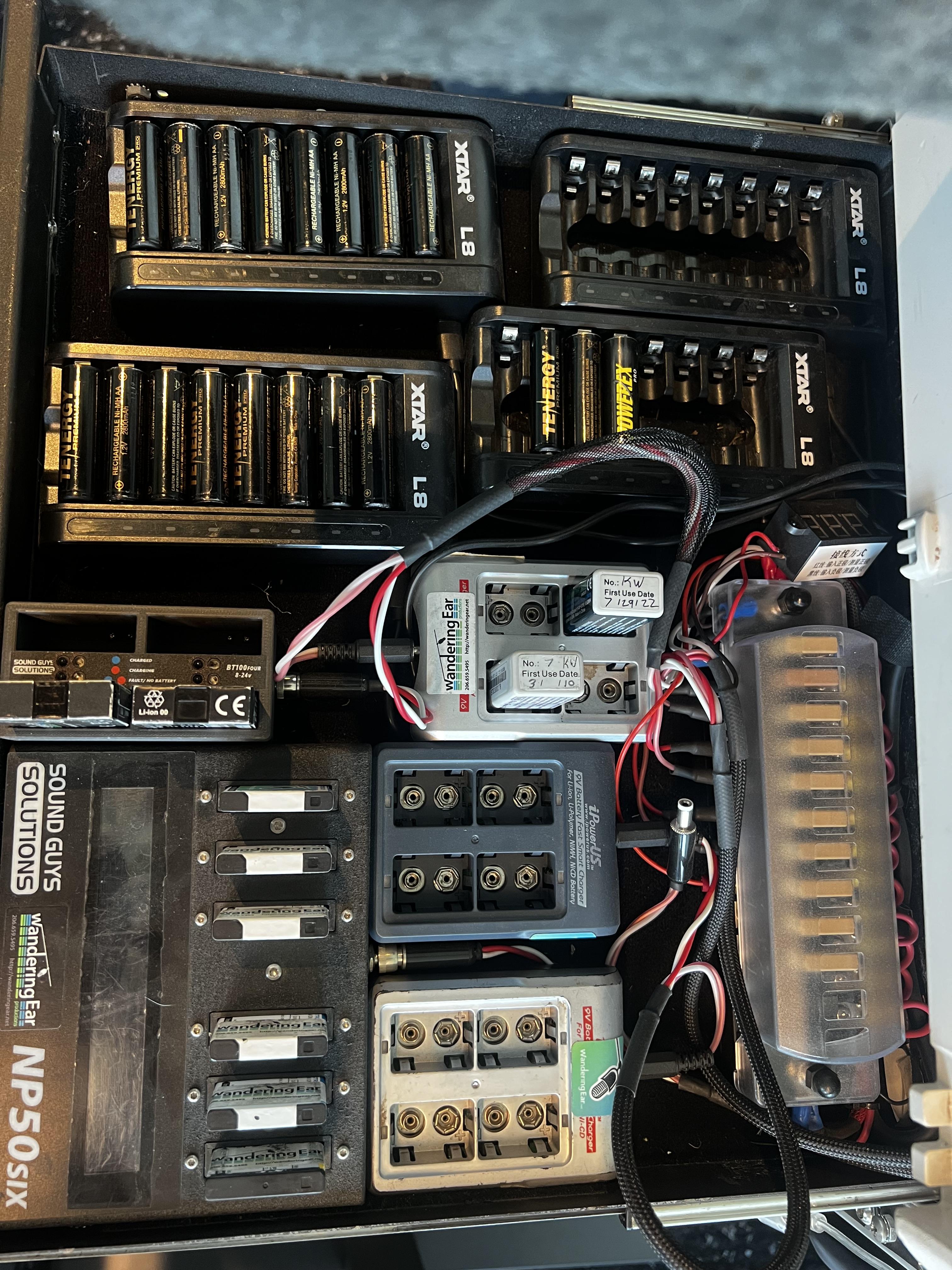

As it sits today:
there are poly fuses on each charger. The wiring’s a mess right now as I swapped out the AA chargers mid show and haven’t cleaned up. The xtar chargers are usb-c and I still need to add Buck converters to move them onto the distro. As always, the carts never done. I really like having everything wired to a single 4 pin xlr. I can pull the drawer off my cart and put it in a pelican, or i can charge small batteries from my LifePO4 bricks i use on my main cart. On the cart they are powered by a meanwell 12v supply
