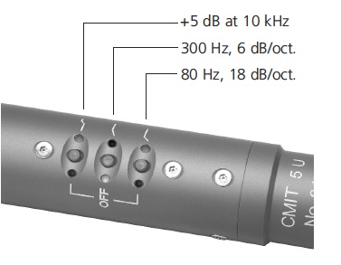

Richard Lightstone, CAS Posted September 3, 2011 Report Posted September 3, 2011 Neil duplicated his post so I'm copying my reply from the first version: The CMIT 5 U has three settings that have confused many. The three buttons are +5dB at 10 kHz, 300 Hz, 6dB/oct. and 80 Hz, 18 dB/oct. Off is Green and on is Red. There is stenciling showing where the off position is, but many just use the color lights and assume "Green means Go". The most common setting is with only the 80 Hz cut on. Of course taking the time to listen and experimenting with the various settings is the ideal method, but sometimes you just put the microphone into service and expect it to sound great -- it's a Schoeps right? The CMIT manual says it this way: The two low-frequency filters start working from 80 Hz and 300 Hz. However, even when these are both switched off, there is another low filter active below 40 Hz at a slope of 6 dB/oct. The steep low-cut filter below 80 Hz (18 dB/oct.) suppresses wind and boom noise. The filter below 300 Hz (6 dB/oct.) is a gentle roll-off that compensates for proximity effects (elevation of low frequencies by directional microphones in near-field use). They also protect against disturbing, inaudible (infra-)sound that can be caused by ventilation systems, track vehicles and wind. What is tricky about this is that although it is hardly noticeable, infrasound can cause strong audible distortions in the connected equipment when it leads to an overload. This would make it impossible to produce a useable record. A high-frequency emphasis compensates for high-frequency loss caused by windscreens and enhances speech intelligibility. Pairs of LEDs next to each pushbutton indicate the status of the filters. Green means “Filter is OFF”, which means constant frequency response curve. Red means “Warning, filter is ON”. The settings are retained when the microphone is switched off. My experience is to use the 80 dB cut only. When you have a chance, give it a try and I know you will love the beautiful warm sound only a Schoeps can give as well as the increased pick up from the longer tube. Quote
