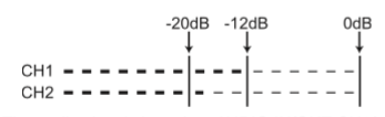

Jaymz Posted April 5, 2016 Report Posted April 5, 2016 Anyone worked with one? I did yesterday and neither myself or the cam-op could figure out how to display large audio meters. The small meters in the bottom are of little use, no idea what the white mark is meant to be (-12dbfs maybe?). I assume the red mark is 0dbfs. Quote
Jim Feeley Posted April 5, 2016 Report Posted April 5, 2016 Which version of the manual is that, Al? I worked with the DVX200 once a couple weeks ago, and IIRC, there was one hashtag for -12dB. Oh, I saved the manual. Page 68 of Volume 2 of the manual and page 68 SHOWS: But I also think there has been a firmware upgrade. So perhaps things are different now? Quote

Jaymz Posted April 5, 2016 Author Report Posted April 5, 2016 47 minutes ago, Philip Perkins said: My Primary Rule For Sound On Dinky-Cams: feed it tone, make sure it's not distorting (like the input is a match for what you are sending, mic or line etc) and "split" the scale. Park the tone right in the middle of whatever meter it is. Works for me. That's what I ended up doing. Good info everyone, annoying that they don't have a -20 mark. Quote
John Blankenship Posted April 6, 2016 Report Posted April 6, 2016 Rather than -20, send the camera max signal and adjust the cam so it is barely below the brick wall. With your nominal at -20 you'll be properly adjusted and ready for action. Quote

Jaymz Posted April 6, 2016 Author Report Posted April 6, 2016 3 hours ago, new mexico said: + 1 to John B's ... "send max signal" - comment: Back in the 'SD 302' days - there was "Full Scale Tone." Without (hopefully) putting too fine a point on things, Jamyz - (And, while attempting to tread lightly here, with - Providing this only as 'food for thought' - No criticism, of any kind is intended, inferred, or implied.) (And, not that any of it really matters, as I understand it - Your only real concern? ... Was just with the display of the camera meters, themselves? - But,) You didn't mention what device, you were feeding the camera, with? What I'm 'taking the long way' to say, is ... If you are using just a 'mixer' to feed the camera? - And, if you have access to a 'Sound Devices 302' mixer? - Why not give the "Full Scale Tone" option a try? (Obviously, all of the above is a moot point ... If you don't access to a SD 302?) This is only my '2 cents.' Good advice =) Knowing that dot is -12, I'll just send a -12 reference out of my 788 next time. Though what I did, going around half way then speaking loudly right into my boom while making sure it wasn't hitting the final red mark, worked. Quote
