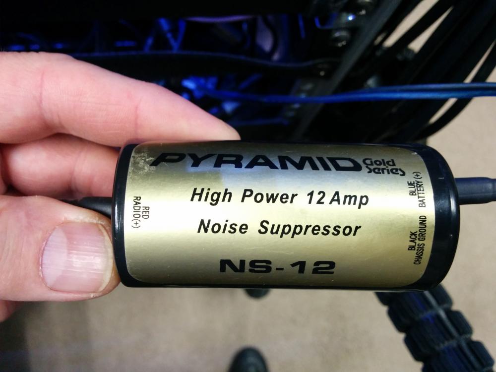

John Blankenship Posted December 14, 2020 Report Posted December 14, 2020 You might try an inexpensive car ignition noise suppressor such as this one. When installed across the DC feed on my cart it completely got rid of the induced whine from an IFB100 transmitter. However, if hum is the major issue when you're powered from the same source, yours may be more of a ground loop problem. Quote
Rick Reineke Posted December 14, 2020 Report Posted December 14, 2020 DC current is usually not subject to ground loop issues. Ignition noise is usually electromagnetic interference (EFI). The above suppressor above should work. A simple clamp-on choke may work as well. Quote
