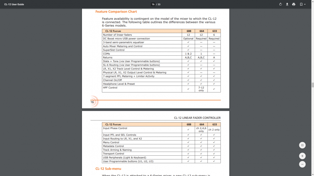

If you've never used the 633/CL12 before, be aware you've only getting a subset of the features you would normally get with the CL12 when with a 688:image.png
https://cdn.sounddevices.com/download/guides/CL-12ug_en.pdf

Iron, that document says that there's no auto mixer control on the 633.
Seems that SD has to update it: I remember having used Dugan - and the corresponding LED on the CL12 was on in each selected channel. Wingman gave more detailed visual feedback. This worked well.
