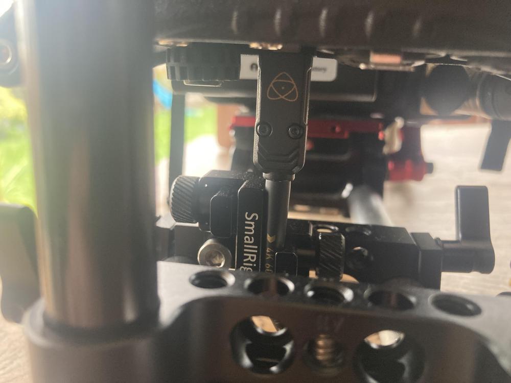

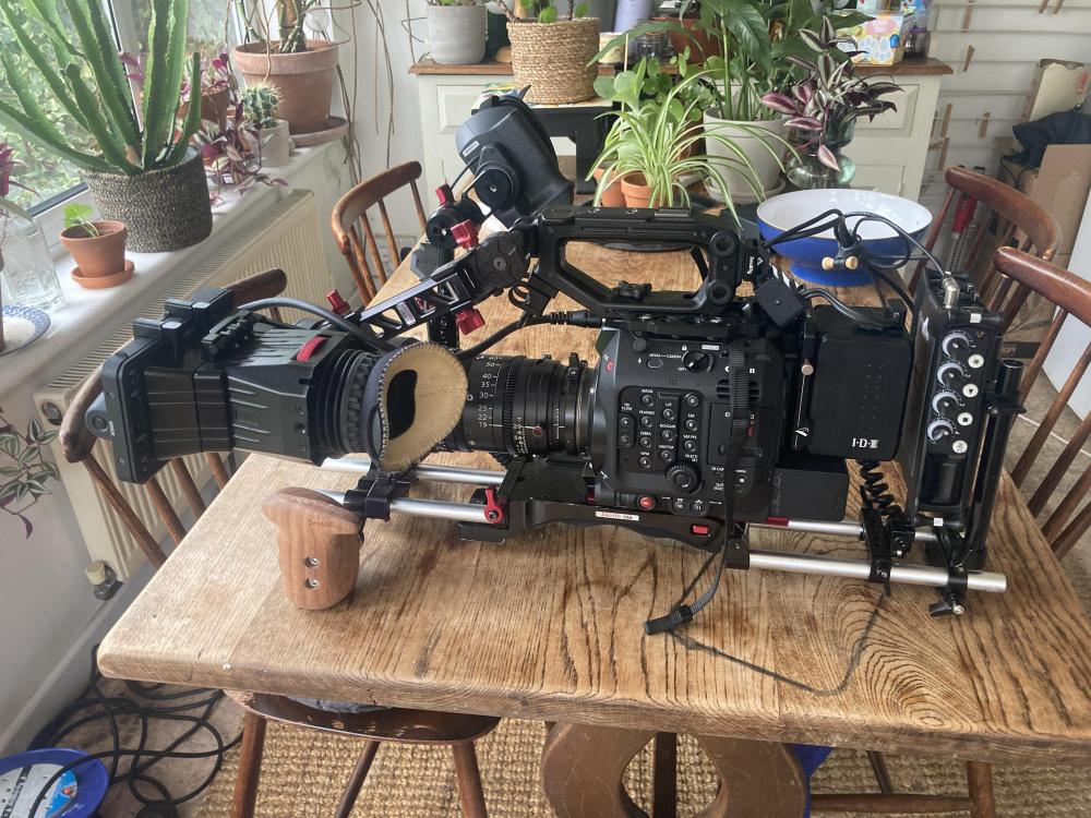

chriskellyfilm Posted February 19, 2022 Author Report Posted February 19, 2022 Thank you for the replies and insights. so i sent the mixpre back to Audio Ltd in the UK and they have been very helpful, they sent me a loaner while they were looking at my unit, and were able to run some tests with me to see what was going on. At the moment the mixpre series will either accept or send TC via aux input, but it cannot do both simultaneously, and it will only send a record / stop signal when set to Rec Run, which incurs this delay (the delay is random in length, usually between 5-9 frames) but they have sent a feature request to allow the unit to send and receive TC via aux in & out simultaneously, and also to allow recording in free run or TOD etc. Hopefully that will be possible and the issue will be resolved. (eg most cameras can output & input TC simultaneoulsy from any of their SDI ports, not only the TC one) Also just FYI the HDMI TC works perfectly, no delays in triggering rec / stop and works with TOD / Free Run etc, the issue is the very flimsy port connection (which they replaced) and the liklihood of the cable coming loose while operating. I have a rig setup (see photos) that should prevent that. On 12/24/2021 at 4:05 AM, The Documentary Sound Guy said: You need to post-process the audio files. thanks for the suggestion i really appreciate you taking the time to think about this, but im loathe to have to introduce time consuming and potentially damaging workarounds to fix a feature that should work (and does work with other setups). Hopefully SD engineers will be able to fix it in a firmware upgrade! Quote
