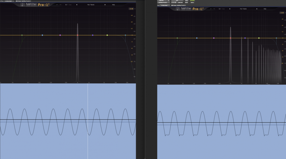

Tinu Posted October 2, 2022 Author Report Posted October 2, 2022 So to anyone interested - figured it out. It was the line input on my 833 which was defective.... Jeez. Picture on the left: 1k -20dB sin into channel 6 Right: into channel 5 Not cool, especially since i had the unit serviced already for the exact same occurrence on CH1. Quote

VASI Posted October 3, 2022 Report Posted October 3, 2022 12 hours ago, Tinu said: So to anyone interested - figured it out. It was the line input on my 833 which was defective.... Jeez. Picture on the left: 1k -20dB sin into channel 6 Right: into channel 5 Not cool, especially since i had the unit serviced already for the exact same occurrence on CH1. Wow Quote
