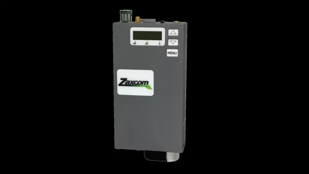

RadoStefanov Posted April 21, 2024 Report Posted April 21, 2024 My thoughts on Schoeps CMD42 and why Zaxcom Nova “oneunit” is too heavy! 🙂 I am very excited about the Schoeps CMD42 AES42 digital amp. I have been using schoeps exclusively for 6+. Ever since my sennheiser MZD8000 digital AES42 amp died. I was using a digital mic preamp for a long time as well before my MZD8000 died. There is multiple advantages of using AES42. In my opinion the sooner the signal chain becomes digital the better for the sound quality and reliability. Aes42 is IMHO the right approach. No need for analog cable runs ,analog front end pres and Analog to digital converter. No more power and RF interference, buzz, crackle, ground loops. 21st century insulation. No more analog artifacts. A lot of my work is multiple setup interviews in Las vegas hotels. It is one hotel room for multiple setups/angles. You setup one, do the interview and than move around the cameras and light for every other user. Using a wireless for boom speeds up the setup and avoid power lines and potential interference. It also sounded a lot more defined. Using digital wireless from a digital microphone kept me for worrying about potential problems. Working in sports arenas is similar. The only point of failure in a pure AES42 microphone is the capsule and the millimeter behind it. Everything else is 100% . The CMD42 is a great tool. Apart from all the advantages of AES42 mentioned above “, superior shielding, reliability and sound quality” the CMD42 has the flexibility of 2 independent channels and most importantly variable Low Cut and pad. I like the pad to also be at the mic capsule and not at the analog front end of the recorder. In fact I want everything to happen right next to the capsule and than flow digitally out of there… There are special digital filters for different capsules. Filters for low frequency loss in directional capsules.The filters for close proximity comb filtering turn the capsules in to P “proximity capsules”. For free. Freaking amazing. There are filters for OMNI and Ribbon “which I will never use” but the filter for parabolic dish seams promising. And I can only assume what the capsule correction for capsules with memory does for us… Capsules with memory???? I was purchasing a cut60 but it was out of stock. I got lucky. Now the money can be used towards a CMD42 giving me “Cell Phone controllable” variable low cut/pad and filters. Considering how expansive SCHOEPS accessories are the CMD42 gives me over a thousand dollars in accessories and thousands of dollars in proximity P capsule filters. Now about the potential advantages with recorders……. Back in the day I removed the analog preamps “among other things” from Nomad to make space for the mix pre II antenna distribution, internal battery and to make the recorder lighter, simpler and have permanent RF,power and AES3 connections. OneUnit design. No more cables failures and interference. The buster father of Zaxcom Nova OneUnit. The only reason I was able to achieve that is using mkh8040 and mkh8060 microphones with the AES42 directly in to Nomad. Eliminating the ancient analog front end and AD converters simplifies the design and cuts a lot of the cost and weight. Also analog front ends fail and get out of calibration. AES42 is superior. Far superior. Now we have CMD42 and Zaxcom can make a simple/lighter recorder “like my Nomad one Unit” by removing all analog front end limiting the outputs to 2 simple channels outs TA5 and 2 simple analog mic/line ins TA5 inputs for the rare times i need to feed something in analog. Why????? Better reliability, lower power usage and lighter weight. Also cost is cheaper. Yes Nova Oneunit is too heavy! 🙂 It has 4 more mic pres than what I need. and 6 more power outputs. Make it simpler and lighter. Call it Zaxcom Nova lite. My back is too tired wearing 5 pounds all in one unit bags. I want 4 pounds. 🙂 Quote

RadoStefanov Posted April 23, 2024 Author Report Posted April 23, 2024 2 hours ago, The Documentary Sound Guy said: Maybe "digital" doesn't, but the CMD42 does. The CMD42 manual specifically warns about it, and the published specs reflect that. As does my experience with the SuperCMIT ... it cuts battery life on the TRX745 by a bit more than a third. As for whether it's worth it ... that's subjective ... I don't think it is. And I think it does matter in the recorder. Zaxcom specs the Nova at 1A @ 12V with 8 channels of Rx, which is 12W. The MRX414 modules each consume 300mA @ 13V, or 3.9W each. That means the recorder itself consumes 12 - (2 x 3.9) = 4.2W on its own. That means a CMD42 will increase the power consumption of the Nova by almost 30%, whereas a CMC6 will increase it by less than 5%. I agree, let's wait for real world performance tests, but, on paper, the CMD42 will noticeably decrease battery life however it is powered. Your numbers are off judging by the mzd8000 experience. it’s true I removed the 6 micpre converters from nomad but I did not loose any noticeable power. let’s wait and see. third of the power from using aes42 seams a crazy. Judging by mzd8000 again by the way I believe supercmit uses more power. Are you using trx745 with AA??? Quote

Patrick Tresch Posted April 25, 2024 Report Posted April 25, 2024 On 4/21/2024 at 7:11 AM, RadoStefanov said: My thoughts on Schoeps CMD42 and why Zaxcom Nova “oneunit” is too heavy! 🙂 I am very excited about the Schoeps CMD42 AES42 digital amp. I have been using schoeps exclusively for 6+. Ever since my sennheiser MZD8000 digital AES42 amp died. I was using a digital mic preamp for a long time as well before my MZD8000 died. There is multiple advantages of using AES42. In my opinion the sooner the signal chain becomes digital the better for the sound quality and reliability. Aes42 is IMHO the right approach. No need for analog cable runs ,analog front end pres and Analog to digital converter. No more power and RF interference, buzz, crackle, ground loops. 21st century insulation. No more analog artifacts. A lot of my work is multiple setup interviews in Las vegas hotels. It is one hotel room for multiple setups/angles. You setup one, do the interview and than move around the cameras and light for every other user. Using a wireless for boom speeds up the setup and avoid power lines and potential interference. It also sounded a lot more defined. Using digital wireless from a digital microphone kept me for worrying about potential problems. Working in sports arenas is similar. The only point of failure in a pure AES42 microphone is the capsule and the millimeter behind it. Everything else is 100% . The CMD42 is a great tool. Apart from all the advantages of AES42 mentioned above “, superior shielding, reliability and sound quality” the CMD42 has the flexibility of 2 independent channels and most importantly variable Low Cut and pad. I like the pad to also be at the mic capsule and not at the analog front end of the recorder. In fact I want everything to happen right next to the capsule and than flow digitally out of there… There are special digital filters for different capsules. Filters for low frequency loss in directional capsules.The filters for close proximity comb filtering turn the capsules in to P “proximity capsules”. For free. Freaking amazing. There are filters for OMNI and Ribbon “which I will never use” but the filter for parabolic dish seams promising. And I can only assume what the capsule correction for capsules with memory does for us… Capsules with memory???? I was purchasing a cut60 but it was out of stock. I got lucky. Now the money can be used towards a CMD42 giving me “Cell Phone controllable” variable low cut/pad and filters. Considering how expansive SCHOEPS accessories are the CMD42 gives me over a thousand dollars in accessories and thousands of dollars in proximity P capsule filters. Now about the potential advantages with recorders……. Back in the day I removed the analog preamps “among other things” from Nomad to make space for the mix pre II antenna distribution, internal battery and to make the recorder lighter, simpler and have permanent RF,power and AES3 connections. OneUnit design. No more cables failures and interference. The buster father of Zaxcom Nova OneUnit. The only reason I was able to achieve that is using mkh8040 and mkh8060 microphones with the AES42 directly in to Nomad. Eliminating the ancient analog front end and AD converters simplifies the design and cuts a lot of the cost and weight. Also analog front ends fail and get out of calibration. AES42 is superior. Far superior. Now we have CMD42 and Zaxcom can make a simple/lighter recorder “like my Nomad one Unit” by removing all analog front end limiting the outputs to 2 simple channels outs TA5 and 2 simple analog mic/line ins TA5 inputs for the rare times i need to feed something in analog. Why????? Better reliability, lower power usage and lighter weight. Also cost is cheaper. Yes Nova Oneunit is too heavy! 🙂 It has 4 more mic pres than what I need. and 6 more power outputs. Make it simpler and lighter. Call it Zaxcom Nova lite. My back is too tired wearing 5 pounds all in one unit bags. I want 4 pounds. 🙂 If I understand the problem you have with your recorder, buy a lighter and better one (wich also accept AES42 inputs). A downside of AES 42 is also that it eats up 2 AES INPUTS. Quote
RadoStefanov Posted April 26, 2024 Author Report Posted April 26, 2024 On 4/25/2024 at 10:58 AM, Patrick Tresch said: If I understand the problem you have with your recorder, buy a lighter and better one (wich also accept AES42 inputs). A downside of AES 42 is also that it eats up 2 AES INPUTS. 🙂 Is there a lighter and better one than Zaxcom Nova OneUnit? I want zaxcom to make a lighter one. I have plenty of AES inputs Quote
