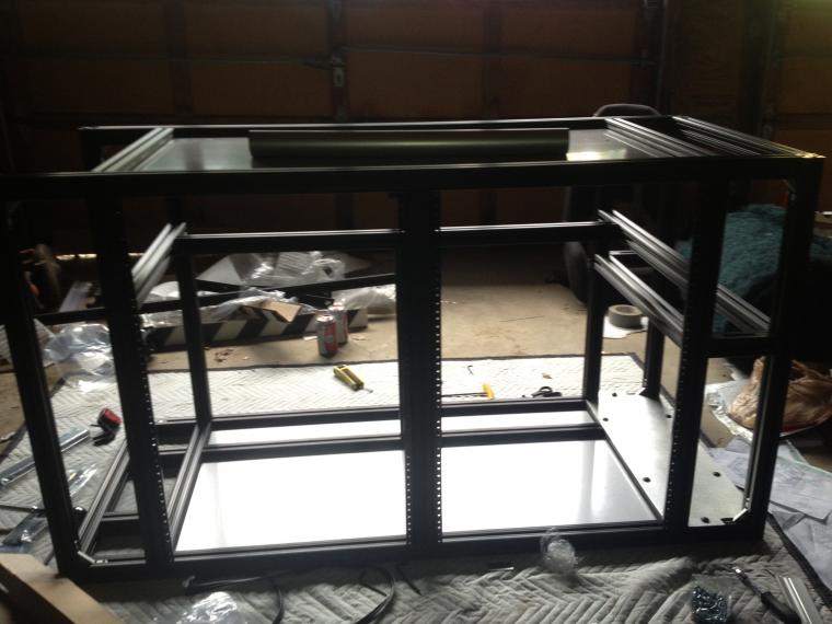

Almost complete. 8020 messed up the handle attachments. New ones coming soon. Also need to redesign the wheel base. I went with the 1.5" 8020 because I wanted a larger bolt size for the wheels. Unfortunately that was still too small. So I designed a plate, but the wheels are now recessed, and somewhat unstable. Workable, but it can be better. I love the look and functionality and all in all it turned out great. (null)

It wasn't too difficult. Had to build from bottom center up. Had a few moments of take apart and rebuild from forgetting to slip in some T-nuts before closing in the ends for pieces that got added later. Biggest gotcha was to not tighten everything right away. Made getting other pieces in on same angle in impossible.

Framework is complete, now waiting for custom pieces and it will be complete. I've already seen some redesign elements for version 2. But that will have to be a few years down the road as this has been a pretty penny to come up with, with all the custom pieces, not pictured. (null)
Adam, that looks great. What did you do about the wheels? My over engineering didn't like using 5/8 bolts max to attach them. I designed a plate to affix mine.

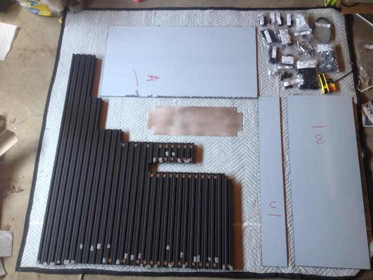

I had access to 3D paper that I drew my cart on. 3D paper being graph paper but with 45 degrees lines as well. So you can draw with depth. Not sure if that makes sense. But it gave a great view of the cart. I copied that drawing several times and used a separate drawing for each element. Inserts, anchors, slot nuts, dimensions. I think I ended up with about 30 different drawings. Well worth it. I tried the Google Sketch, but I could draw faster, and the paper really helped.
Not cheap!! I'll have a better number for you when everything is here. Still waitin for drawers, customs drawers, and custom handles, LED light, hooks, etc. As most custom pieces go, you'll pay for it. I over engineered this to withstand the rigors of my set. I didn't want it to rattle apart. But putting some of these pieces together so far, I realize I could've saved some money with going with single anchors vs double anchors, in places. But that's pretty marginal in the grand scheme of things. These pieces really do hold on tight and sturdy. Could've also gone with the 1010 vs the 1515, with the amount of structure I have built in. But it was suggested by several vets in the business to go with the 1515. If I build again, I'm definatley going with 1010. I'll save weight and money. When you buy from these guys they charge a lot for counterbores, tapping, and notch services. I could've done the tapping, but I figured I might a well just have them do it, since I already had them doing counterbores that I was not comfortable doing. I'll soon know if the over engineering was beneficial. Picking up the pieces, these things are not light!!
Thanks, this has been a year in the making. Design, redesign, waffling, redesigning, second guessing, and finally pulling the trigger. With so many pieces, I had to letter them. Alas, 80/20 cut one major piece 1/2" too small. So the building has come to a screaching halt!! It will give me time to draw and get the custom pieces built. Oh well. You'll see the progress soon enough. Dang!
