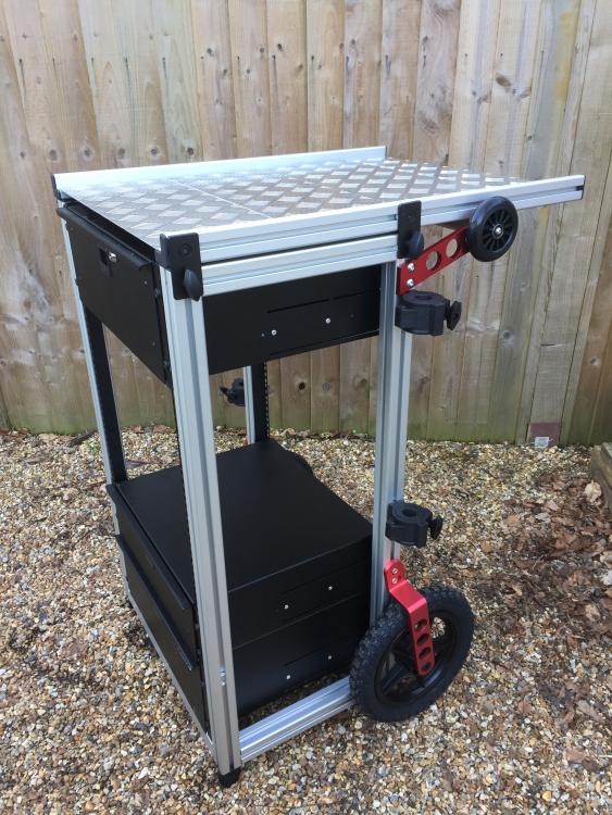

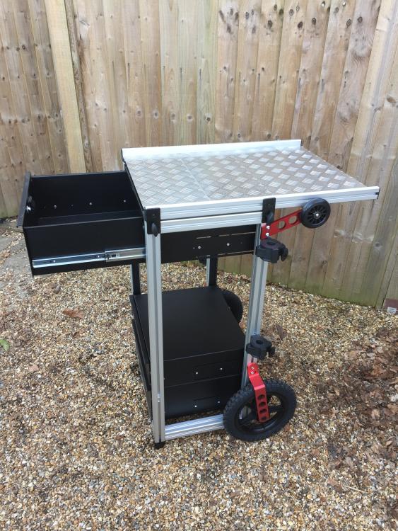

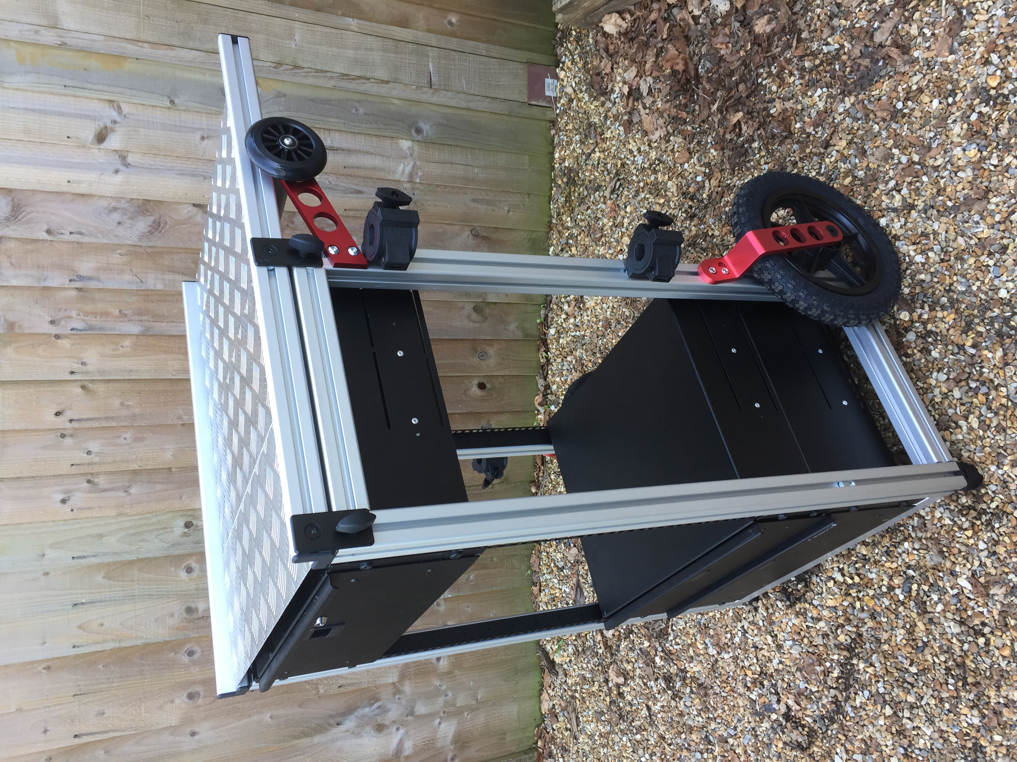

Matt Bacon AMPS Posted March 15, 2017 Author Report Posted March 15, 2017 This is my soon to be launched Follow Cart concept. I'm still waiting for a few parts to arrive so it can be beta tested. It features 20u of 19" storage space, detachable worktop, compatibility with our range of universal accessories (boom holders, antenna holders etc.) Any requests while we are in the final design/testing/phase? Estimated RRP £1,000+VAT Quote
Bash Posted March 16, 2017 Report Posted March 16, 2017 Could the work surface flop down over the front of the drawers, to keep them closed when it is stowed? sb Quote
Jeff Wexler Posted March 16, 2017 Report Posted March 16, 2017 I think Matt was saying that the top work surface is detachable and stows on the front or back for travel. I don't think it has any folding mechanism which would allow it to stay attached. Quote
RPSharman Posted March 16, 2017 Report Posted March 16, 2017 There should be a bottom shelf so muck on the ground or wet grass doesn't get on the bottom drawer. Quote
Matt Bacon AMPS Posted March 16, 2017 Author Report Posted March 16, 2017 9 hours ago, Bash said: Could the work surface flop down over the front of the drawers, to keep them closed when it is stowed? sb Yes it does. 8 hours ago, RPSharman said: There should be a bottom shelf so muck on the ground or wet grass doesn't get on the bottom drawer. There will be a shelf that will do just that giving you a 490mm x 310mm area. Quote
