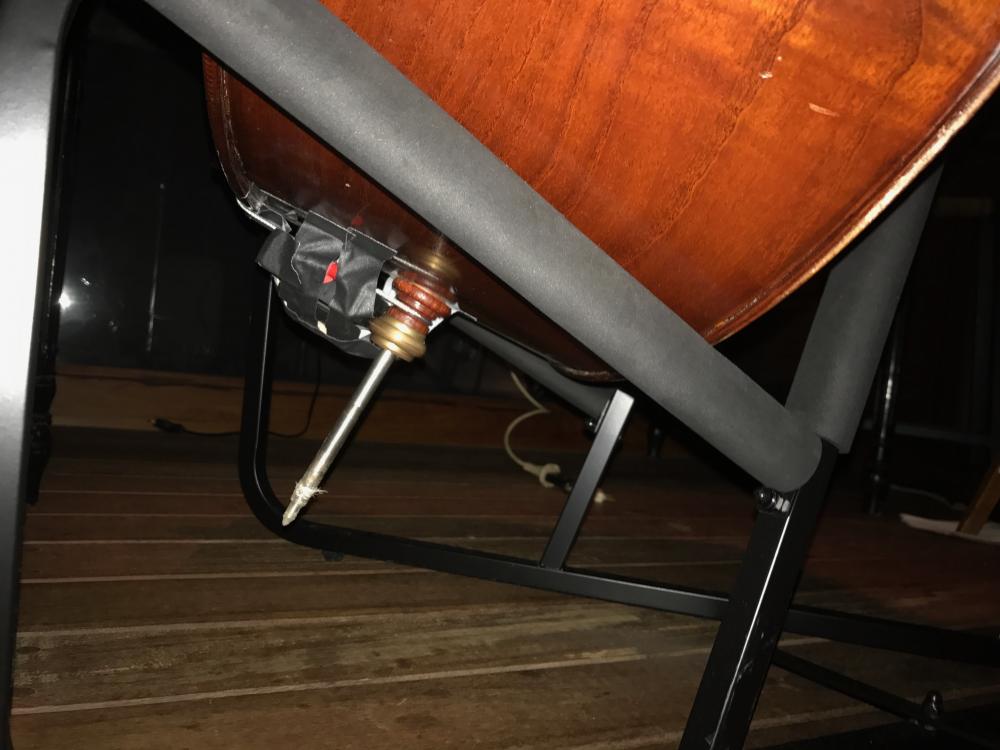

foliver Posted August 6, 2017 Report Posted August 6, 2017 Hello group, 'm posting here a recording ( just the dpa track) i made yesterday, in a difficult situation. see the picture. Dpa 4061, Lectro 211, Cantar. I was schocked by the dpa. Fabian contrabajo dpa lectro Aaton Cantar.m4a Quote

sarcanon Posted August 7, 2017 Report Posted August 7, 2017 Sounds good. Where did you mount the 4061? Quote
jhharvest Posted August 7, 2017 Report Posted August 7, 2017 Yeah, that sounds lush! Good job! I think I would have tried to convince the director we don't need to conceal the lav altogether, just with a furry in the normal bridge position but you really made that mic work. Is it for a narrative production? Could you spill the secret location? Quote
foliver Posted August 7, 2017 Author Report Posted August 7, 2017 Hi, it's a feature film, so no way to have it exposed.. The tx was a high power 250C I don't know the double bass parts in english to describe the position, so it's better to post the pictures. Sticky+overcover, and some black tape. Sorry for the picture size but i'm running to the set! Quote

MarkC Posted August 7, 2017 Report Posted August 7, 2017 The mic is attached to the inside of the tailpiece and the transmitter to the endpin. I insert the 4061 inside the heart of the bridge with a foam windscreen and then cable tie the transmitter to the inside of the tailpiece. The sound I get from my double bass is very nice for me too. I am also attracted to the 4061 because it doesn't inhibit/dampen the vibrating parts of the instrument. Strange setting for a double bass, what is the film? markcauvin.com Quote
The Immoral Mr Teas Posted August 7, 2017 Report Posted August 7, 2017 Good call for position, Fabian. I play viola, and have often miked it with a 4060 - rather than 'studio' choices of Bruel & Kjaer, Schoeps, ribbon ... ha, my skill level doesn't justify even the 4060! I have a couple of the violin mounts designed to go with the 4060/1; they go to the strings just behind the 'bridge', so very close to where you put the 4061. With the extra room behind the tailpiece on the cello and bass (compared to violin/viola) it's an ideal 'mounted' hiding place with minimal extra coloration, so good choice. Jez Quote
foliver Posted August 7, 2017 Author Report Posted August 7, 2017 Hi Marc. I was not able to stick the mic in the bridge, because the cable stays exposed when running to the tx. i was thinking to stick the tx in the tailpiece, it's a nice place for frontal shot, buy if the short was done from the side of the instrument it will be exposed... it's a film, about two families, living at the seashore, the girl is the daughter of one of them. Quote
