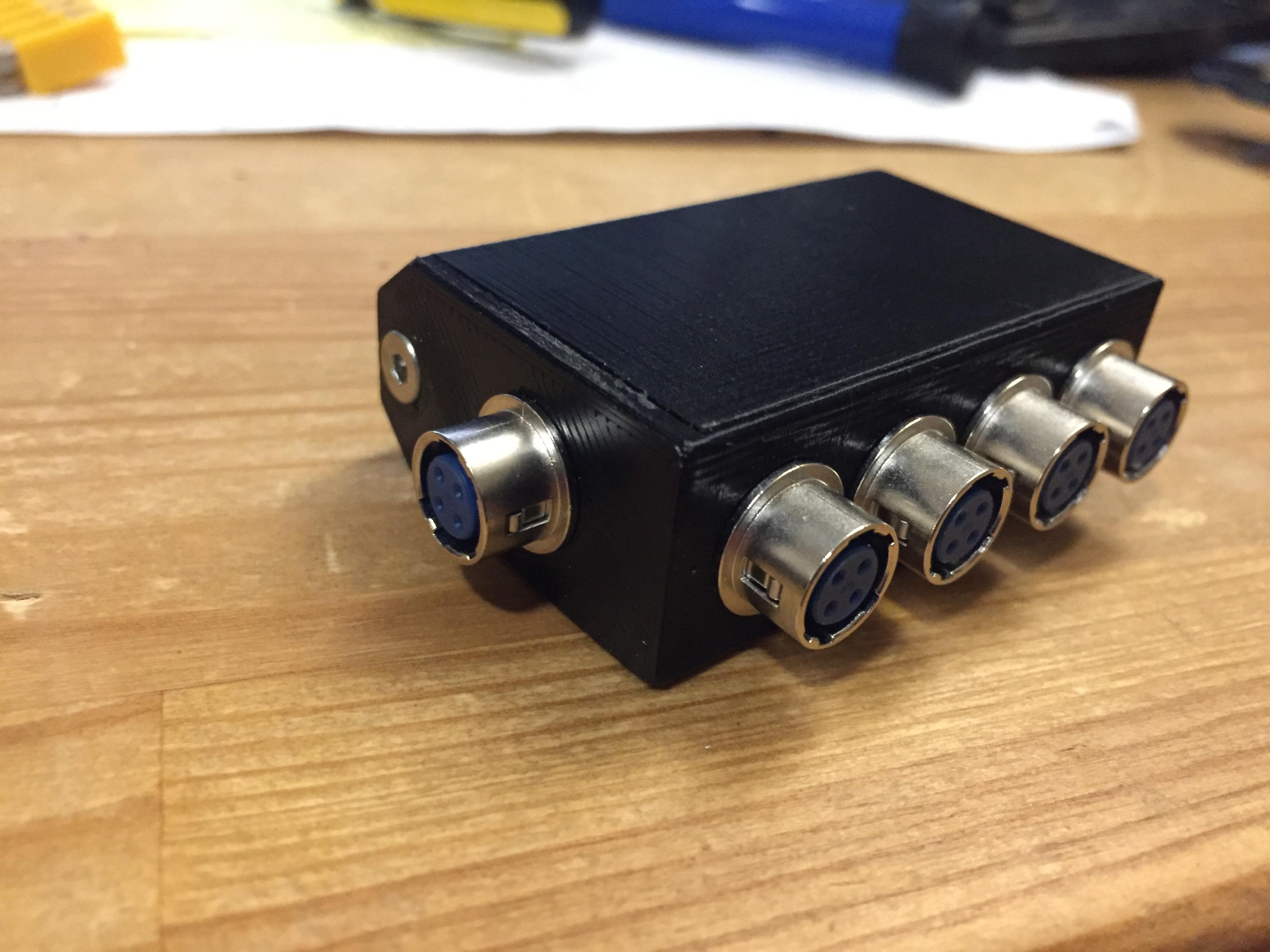

Dave Williams Posted June 19, 2019 Report Posted June 19, 2019 Just a quick showcase of an idea I've been toying with lately. I'm thinking of this as a sort of sub-distro and it will hang off the main BDS (or could easily be stand alone if need be). It's a pretty simple device; just a poly fuse on each output. Quote
Shastapete Posted June 19, 2019 Report Posted June 19, 2019 this is great, I made something similar using the switchcraft locking BDS jacks, but I've since switched over to hirose something like this is missing from my "oh shit" case Quote
Mike Westgate Posted June 20, 2019 Report Posted June 20, 2019 Very neat job! Are the yellow components thermal fuses ? mike Quote
Dave Williams Posted June 20, 2019 Author Report Posted June 20, 2019 19 minutes ago, Mike Westgate said: Very neat job! Are the yellow components thermal fuses ? mike Thanks! Yep, they are 2A PTC Resettable Fuses, although I saw that in the data sheet that a Hirose connector is only rated at 2A anyway, so if you were at the stage of tripping one or more of those fuses, I guess the input connectors would be at or past their limit. I might change them out for smaller ones at some point, at least it gives some protection for a dead short! Quote
Mike Westgate Posted June 20, 2019 Report Posted June 20, 2019 Great stuff I suggested those to Remote Audio years ago as with a diode they can also offer polarity protection Cheers mike Quote
daniel Posted June 20, 2019 Report Posted June 20, 2019 So compact - very nice. Better than just being small it's also as flat as anything with a hirose could be and in the bag I like that. Quote
