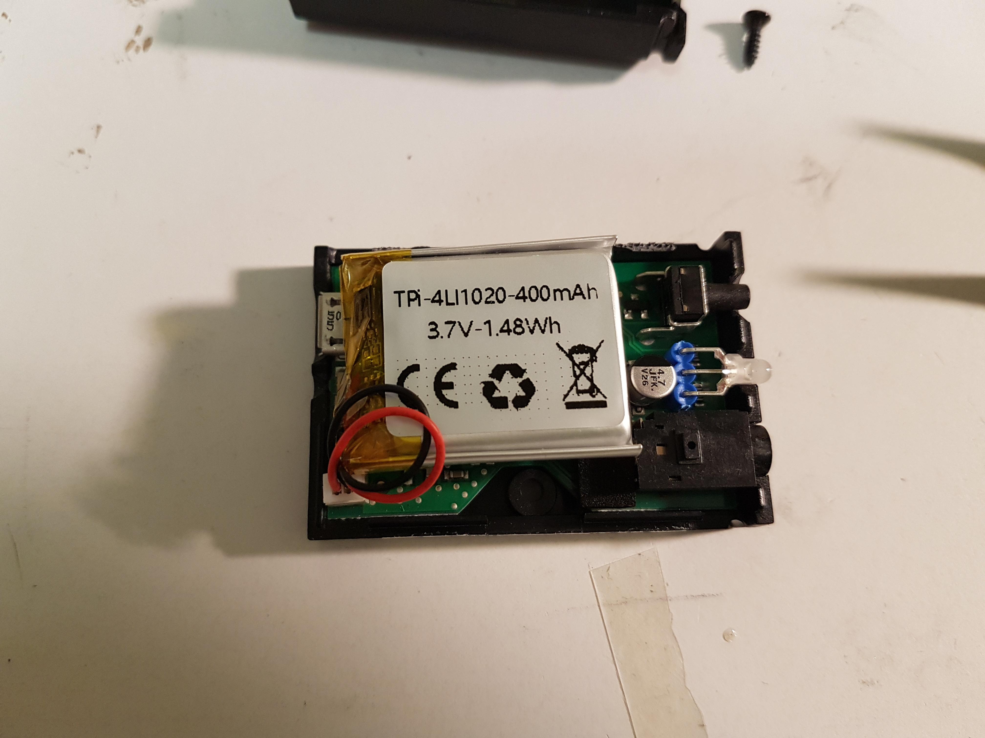

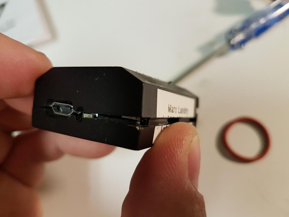

Hi all, if like me you have a Tentacle Sync version 1 with a weak battery, then like me, you probably are having a terrible time finding any information on how to change it. Most retailers I contacted did not have stock on this part, let alone know that the part was available from Tentacle. Its an easy fix.
The battery replacement kit which comes with a battery, new plastic housing, velcro hook tape, super glue and rubber color bands.
I was able to open mine without causing damage to the original housing, so I just glued it back together on the side of the case opposite the screw.
Here are some pictures:
Thanks! It's good to know how to open them and what kind of battery is inside. Even if the guys from TentacleSync are located 30 miles from my hometown. So to get the repalcement battery kit would be easy for me anyways  :)
