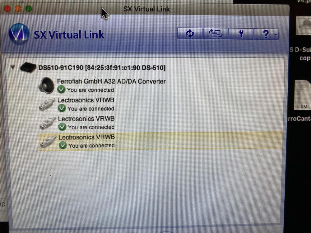

Erik Meiselman Posted August 27, 2020 Report Posted August 27, 2020 So I was Successful in getting Wireless Designer to work over ip to a Silex DS-510 USB Server to a pair of VRField Venues. I used a Mac Mini with Catalina on it. The beta driver is allowing me to run this setup. I had tried to originally use my older MacBook Pro with High Sierra, SX Virtual Link would recognize the Venues, but it would not connect to them. I did not use the device server. Erik Meiselman Quote
S Harber Posted August 27, 2020 Author Report Posted August 27, 2020 So it all is working quite well. 18 wires on 3-Venues. A Ferrofish A32 interface (analog to Dante) The Ferrofish alone and then the 3-Venues on a USB hub feeding into the 2-USB inputs of the Silex 510. That outputs Cat5 into a switch along with Dante signal another from the Ferrofish. Sent to my mixer cart via Cat5/6/Ethercon That hits a switch One leg goes to a Cantar Another leg to a thunderbolt adaptor then into my laptop on High Sierra. Many links but no issues getting on to Wireless Designer from up to 300'+. Thanks for the help everyone. I'll post if anything noteworthy plays out. SH Quote
