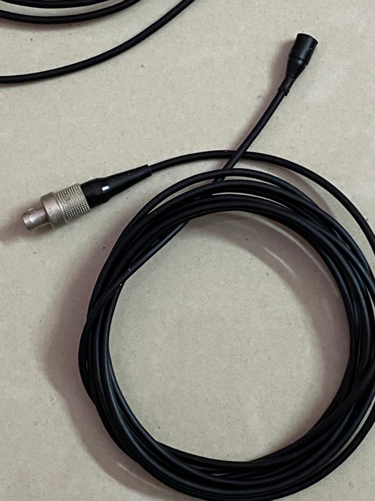

KISHOR CHAUHAN Posted October 3, 2020 Report Posted October 3, 2020 Hey Foliver We Replace Cable of Sanken Cos 11D as well as DPA 4060.Cable is much better than Mogami which we replace.It is Soft and Reliable wont become Harder.kindly Send Your Quories at info@soundtrackkservices.com.Thanks Looking forward for your Reply. Quote

RadoStefanov Posted October 6, 2020 Report Posted October 6, 2020 3 hours ago, KISHOR CHAUHAN said: 40 USD Per Cable Replacement Charge Do you have a picture of a repaired DPA mic? I have maybe 8-9 DPA 4063 mics with harden cable that I would love to repair. Quote
RadoStefanov Posted October 6, 2020 Report Posted October 6, 2020 4 hours ago, KISHOR CHAUHAN said: 40 USD Per Cable Replacement Charge I have to send the mics to India? Is this you? https://www.facebook.com/soundtrackkservices Quote
petersont Posted October 6, 2020 Report Posted October 6, 2020 +1 - and looking at the DPA rewire above ( assuming that is in fact Kishor...) is black the only available cable color, ie no white or tan? Thanks Quote
