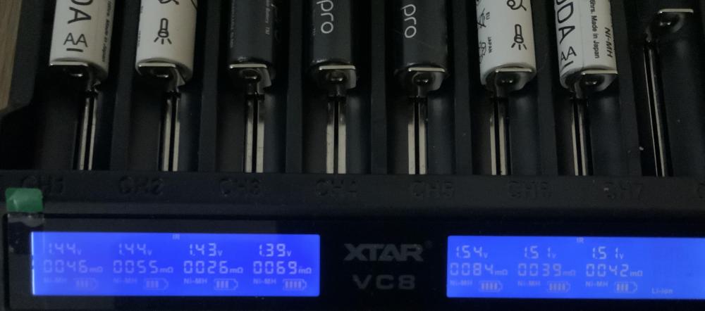

Sound Posted October 4, 2021 Author Report Posted October 4, 2021 On 10/3/2021 at 9:23 AM, DanieldH said: Jepp... My ISDTs also show similar "optimistic" values, where as the Maha produces values that correspond more to those advertised. My guess, is, that the ISDTs and maybe your XTAR does not show the actual charge of the battery, but the energy it has pumped into it, including loss to heat. On the other hand, the firmware might just not be well calibrated. It does not matter to me anyhow, because I see when my 2450 Ikea Ladda produces odd values (also internal resistance). Then I mark them as less good or dispose them. You can also see, if a battery behaves different to same aged sisters or you can pair batteries with similar values. If I am to test some completely unknown batteries, I use the Maha. Speaking of resistance, which values are odd? I get huge variations.. Quote
DanieldH Posted October 4, 2021 Report Posted October 4, 2021 I've had a battery with somewhere @ 600mΩ. It performed badly anyhow. I get similar variations, but IIRC Isomewhere in the 100 to 200 range, but I might double check. I currently have some batteries "from the university" on analyze in an ISDT out of curiosity. Unfortunately I did not bring my Maha. Quote
