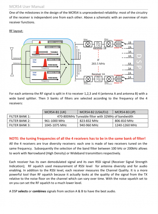

Michiel Posted February 10, 2022 Report Posted February 10, 2022 I did a quick first walk test today with MCR42 and MCR54 on the same frequencies and the MCR54 actually had better reception over long distance. Something I did not know prior is that all 4 channels must be within 32mHz of each other. This limits the claimed frequency freedom to quite some extend in my opinion. Quote
Mark Posted February 12, 2022 Author Report Posted February 12, 2022 Is the 32mHz limitation based on filters in the unit? I was not aware of this. Is this in the manual somewhere? Quote
