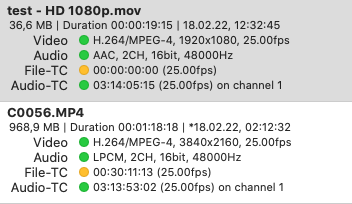

Sound Posted February 18, 2022 Report Posted February 18, 2022 Hi, I am syncing video to audio via timecode using two ultrasync ones on a zoom f6 and a sony a7 III. Zoom f6 is set to output timecode to the USO and this transmits TC to the USO on the a7 III. Then I sync using tentacle sync and export as media files. Usually this works perfekt and I have done so for lots of shooting days and hours, but this time there is one clip in the middle of the shooting day with audio shifted from video about a minute or so.. In tentacle it shows as audio-TC found. All other files before and after this clip are in sync. Did anyone experience the same problem? I havent started or stopped audio recording between those video clips. Does anyone know what could possibly have happened and how to prevent this issue? Where can I look for those problems to find out whats causing the shift??? LTC-Convert shows the same timecode for video. So maybe its a problem with the USO or the F6? Quote
Sound Posted February 18, 2022 Author Report Posted February 18, 2022 I cut off a piece of the video an timecode shifts accordingly. So it cant be a short interruption or noise at the beginning of the clip.. Quote
