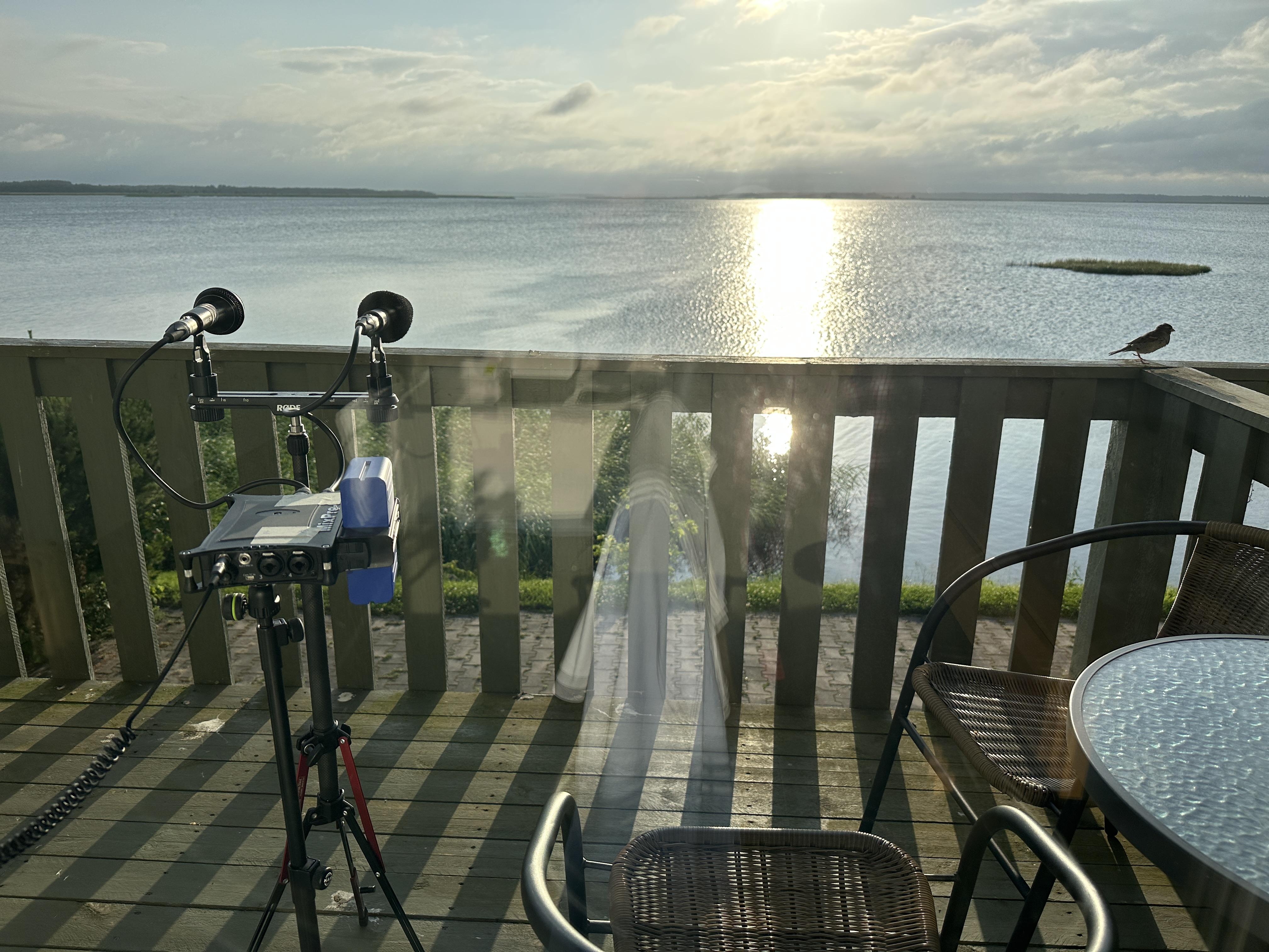

inspire Posted June 27 Report Posted June 27 In place, stunning quality IMHO. (For my 55 birthday) Quote
