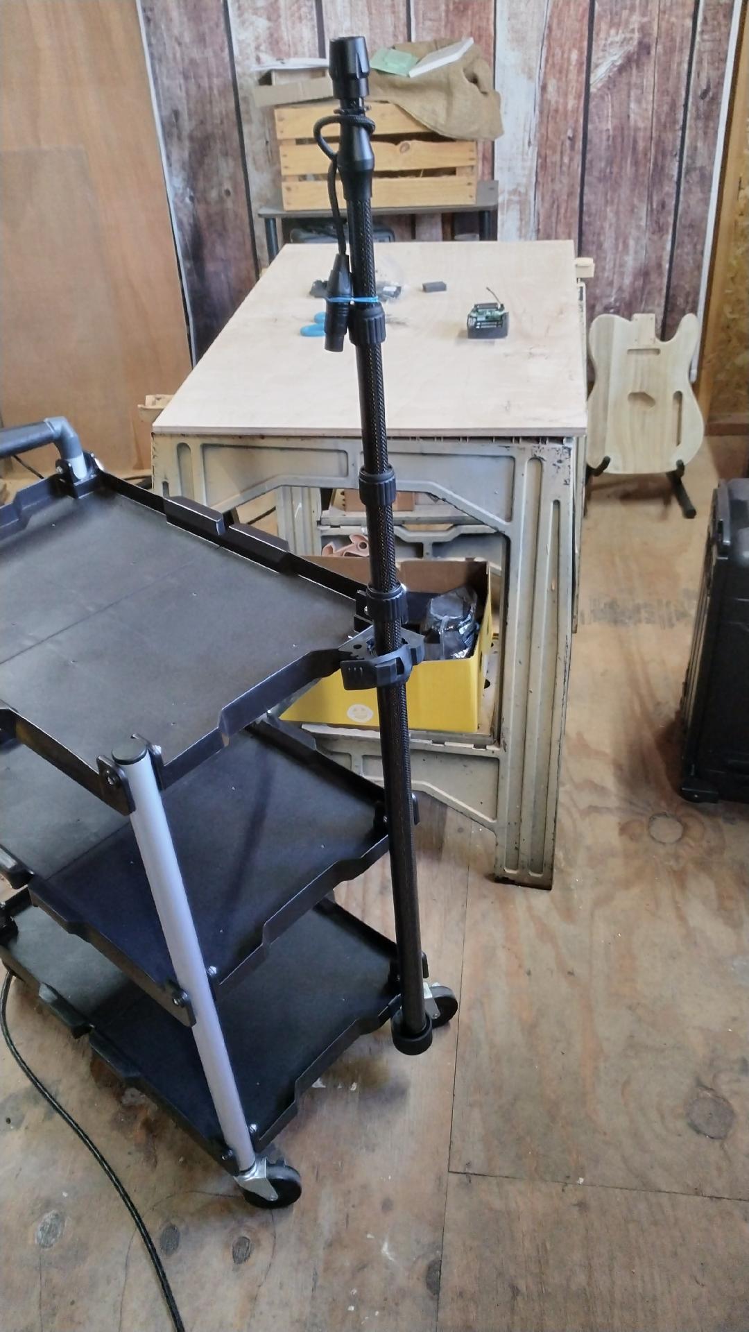

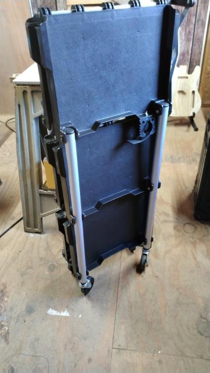

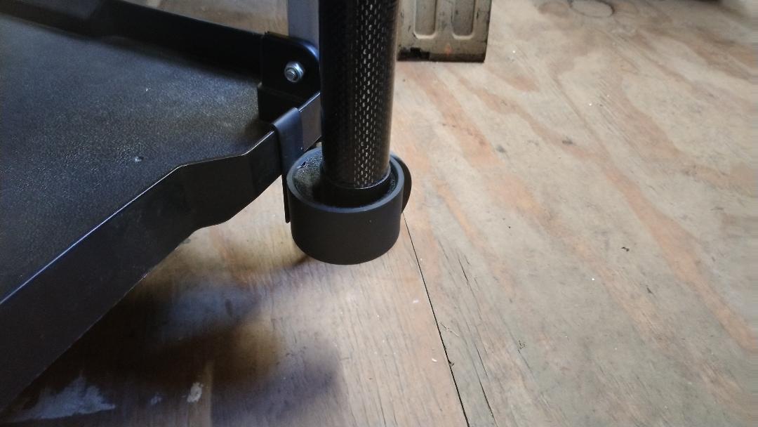

I got the boom pole cup finished. Worked out pretty well I think! I am glad that I foresaw the castor hitting the cup, and made it removable! Still folds (Pretty much) as it should. Holds the boom very secure!

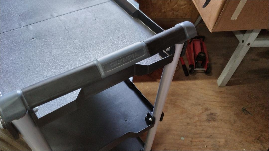

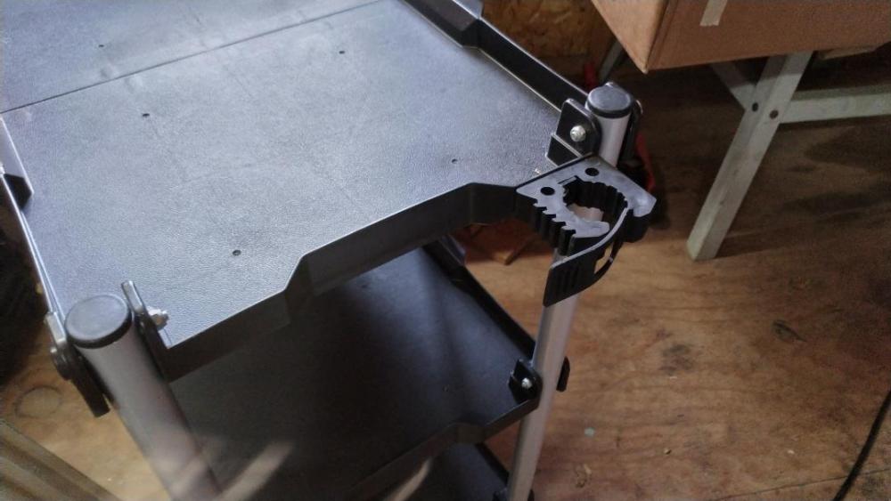

I am currently modifying my Olympia Tools 85-188 cart. I removed one of the side handles (there are bushings that go through the plastic handle that you will need to remove before the handle will come off). And I found some caps that fit the tube perfectly! https://www.amazon.com/4pcs-Pack-Plastic-Furniture-Finishing/dp/B07PSNYLN6/ref=sr_1_7?keywords=30mm+pipe+cap&qid=1639074510&sr=8-7 I removed the handle so that I could mount a "Quick Fist" clamp to the top shelf without the handle being in the way. Also I am building a little cup that will slip on the lip of the bottom shelf. I will post photos of it after it is finished.
