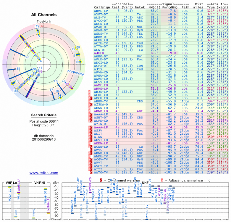

Glyn Posted August 3, 2015 Report Posted August 3, 2015 Reigniting an old thread. I am going to be in Chicago mid september recording with a couple of wireless lavs. I will be at the Chicago Marriott Downtown Magnificent Mile. What are the available frequencies? Have they changed from what has been mentioned above. Thanks in advance. Quote
Matt Mayer Posted August 3, 2015 Report Posted August 3, 2015 If anything, things have gotten worse. If you are inside, you can probably get away with any block. If you are outside, the RF is really strong since you are blocks from the major TV transmitter site in the city (John Hancock building and Sears Tower). Not sure if this link will work, if not, just go to the site and use the "Check your address for free TV" link http://www.tvfool.com/?option=com_wrapper&Itemid=29&q=id%3d8e033b97601d8d Based on this chart, looks like, without doing the math and looking up block frequency ranges, you can find clear air in blocks 19, 20, 23 and 25. Quote
