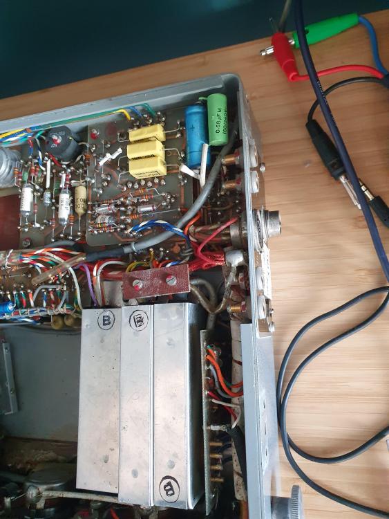

hallvard Posted April 15, 2020 Report Posted April 15, 2020 Sorry to add more questions, but I have a switch and an extra connector (Tuchel) on the right side of my 1967 Nagra III. Don't see these in the 1963 manual. Anyone know what they are for? Cheers, Hallvard Quote
Glen Trew Posted April 15, 2020 Report Posted April 15, 2020 Looks like someone managed to instal an internal crystal and an on/off switch. Seems well done except for the label. Factory, maybe? It should pretty obvious by opening the deck and taking a look inside. Quote

hallvard Posted April 16, 2020 Report Posted April 16, 2020 Thanks! The switch is very short, so it is hard to accidentally flip. So if I only record without need for sync (and might want to edit tape) - do I turn it to crystal or 50 Hz? Any idea on the connector? I have seen the additonal connector on one other machine on youtube - sure that is not an addition Nagra made to later models? Seems tidy inside. Cheers, Hallvard Quote
Glen Trew Posted April 16, 2020 Report Posted April 16, 2020 18 hours ago, hallvard said: Thanks! The switch is very short, so it is hard to accidentally flip. So if I only record without need for sync (and might want to edit tape) - do I turn it to crystal or 50 Hz? Any idea on the connector? I have seen the additonal connector on one other machine on youtube - sure that is not an addition Nagra made to later models? Seems tidy inside. Cheers, Hallvard The options are either ON or OFF. The selection you want if not needing locked sync is OFF. Quote

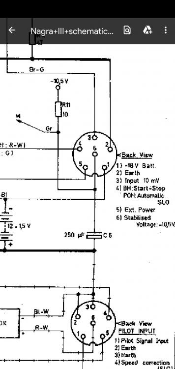

hallvard Posted May 7, 2020 Report Posted May 7, 2020 (edited) I am ready to solder up the Tuchel connector for an external PSU. But I am a bit uncertain about the pinout in the schematic (see below). What does "back view" mean? Is this seen from inside the Nagra or outside? I plan to solder to the pins matching 2 (plus) and 5 (negative), but not sure if 2 is up and right looking from the outside or up and left. I tried to measure 2 and 4 relative to ground, but got zero ohms for both... Any help would be appreciated! EDIT: Back view means as seen from the soldering side of the connector, inside the chassis. So I got it working with 2 positive and 5 negative. Edited May 13, 2020 by hallvard Quote

hallvard Posted May 9, 2020 Report Posted May 9, 2020 (edited) Thanks alexbooy! I can then check the schematic for the IVS. That is great help. It also corresponds with what I thought (the most sensible interpretation of "back view"). The wiring inside goes to ground on the line in from one of the pins, so that's another hint :). EDIT: It was the same pinout. Thanks again! Edited May 13, 2020 by hallvard Quote
