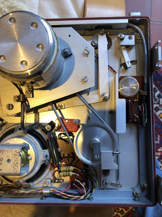

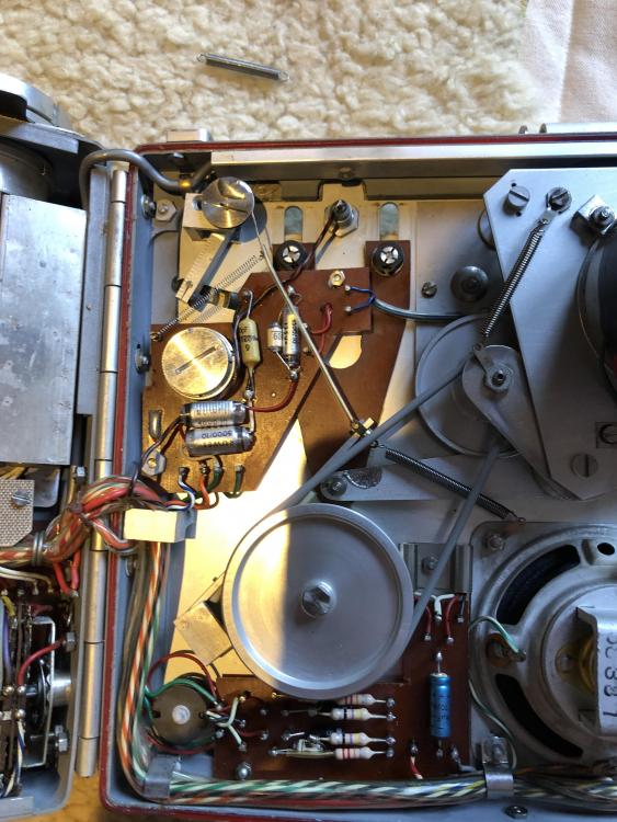

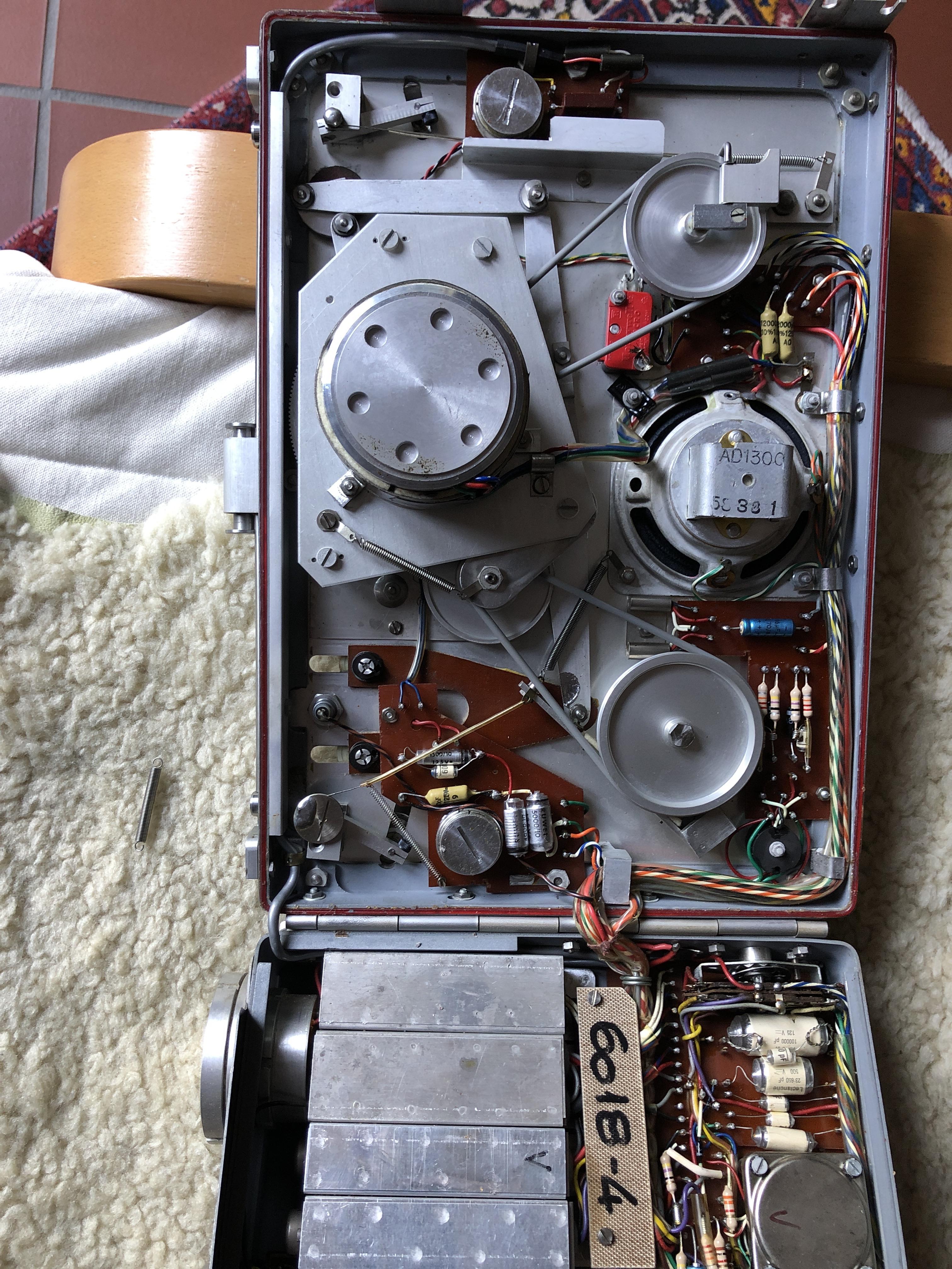

There was something rattling inside so I opened it up and found a completely detached spring. (I've attached pics). I've compared my unit to pictures of other opened-up Nagra IIIs online, but I can't see where this spring came from.
I also sent the pics to the owner as well, but I think he's at a loss too.
Anyone know off hand where this spring should go?

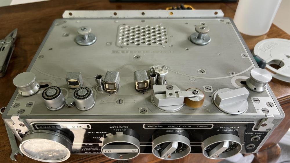

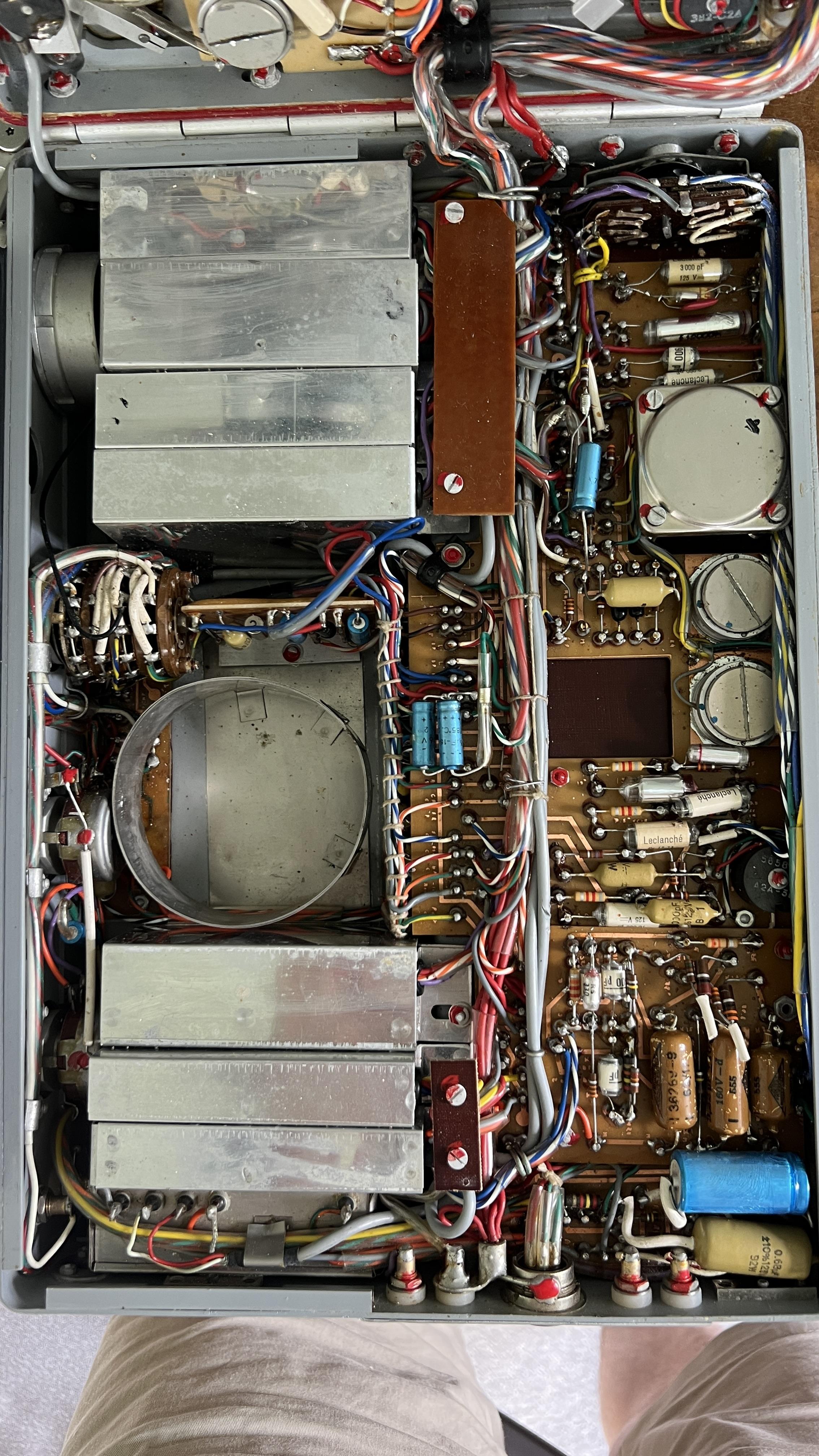

Hello everyone - I’m also jumping into this thread as a first time Nagra owner :)
I have just purchased a Nagra III (a basic B model from 1963). I’m London, UK based. It looked like a good bet - has the leather case, looked tidy but not too clean in the pics, helpful seller etc.
I’ve given it a thorough and careful clean - heads look good, pinch roller seems to have lots of life in it, playback sounds good through the internal speaker, dust cover was moderately yellowed so I’m peroxiding that as I type.
Couple of possible issues - the lower tape speeds/EQs function as expected but the 15ips speed seem to be inconsistent… under no tape load it actually slows down from the 7.5ips setting.
I heard absolutely no mechanical noise from the internals with normal playback but rewind creates a loud whirring noise.

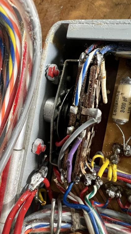

I’ve opened it up and have spotted a bit of what I assume is battery discharge gunk crystallised around the underside of the back left of the unit - easy to clean up but I don’t know what it may have done to anything it contacted. I can see it in the battery compartment but that’s probably been cleaned previously. The unit had a calibration seal (from 1981) that I removed to open it up.

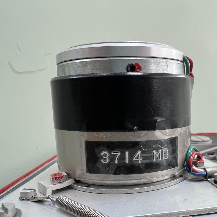

The motor has a large Dymo tape code on it - not sure what this might signify? A previous service/repair perhaps?
The noise seems to be play somewhere around the top of the motor area causing vibration. It’s noisier with no tape causing loading but not noticeable at normal playback speed.
I’ve not been able to test recording (no suitable mic or banana plug cables - Amazon is delivering the latter so I can test line input and output which is how I plan to use it).
All thoughts and advice gratefully received!

Hi SimonSays - I'm wondering if you ever discovered the issue with your slow 15ips?
I've had my Nagra III for a few years now, and have only used it on 7.5ips - to my horror the 15ips setting is indeed slower than 7.5ips, just as you pointed out with your recorder.
Did you have any updates about that please?
* actually, I tried again and it does get up to speed but only if I press the FF button to ramp it up. In any case, if anyone has ideas what I should look at that would be helpful.
** 2nd EDIT I'll leave my findings here for anyone else in the future. 15ips works perfectly if the speed dial is changed while in "stop" mode. False alarm - works 100% now
