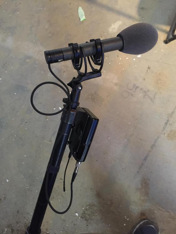

Moesound Posted September 30, 2021 Report Posted September 30, 2021 Hello, I've been using the A-10 system since they were first introduced, and with my Schoeps CMC641's there has never once been an issue with RF noise. I've used them exclusively with Cinela and Rycote mounts. Now, on my older Neumann 81 and 82 there was a buzz. The workaround for those older mics was to apply a small strip of electrical tape over the release of the XLR, depressing it slightly, and this has worked every time. Ideal? NO, but it works. Also, the original blue cap cables I believe were too short. I keep them for backups, but I use the newer, longer versions with the A-filter built in. I guess I've just been lucky. Audio Ltd should be addressing your issues. However, they are now owned by Sound Devices and I'm not sure what their level of commitment is at present regarding the A-10's. Attached is a photo of my typical interior setup. Regards, Moe Quote
