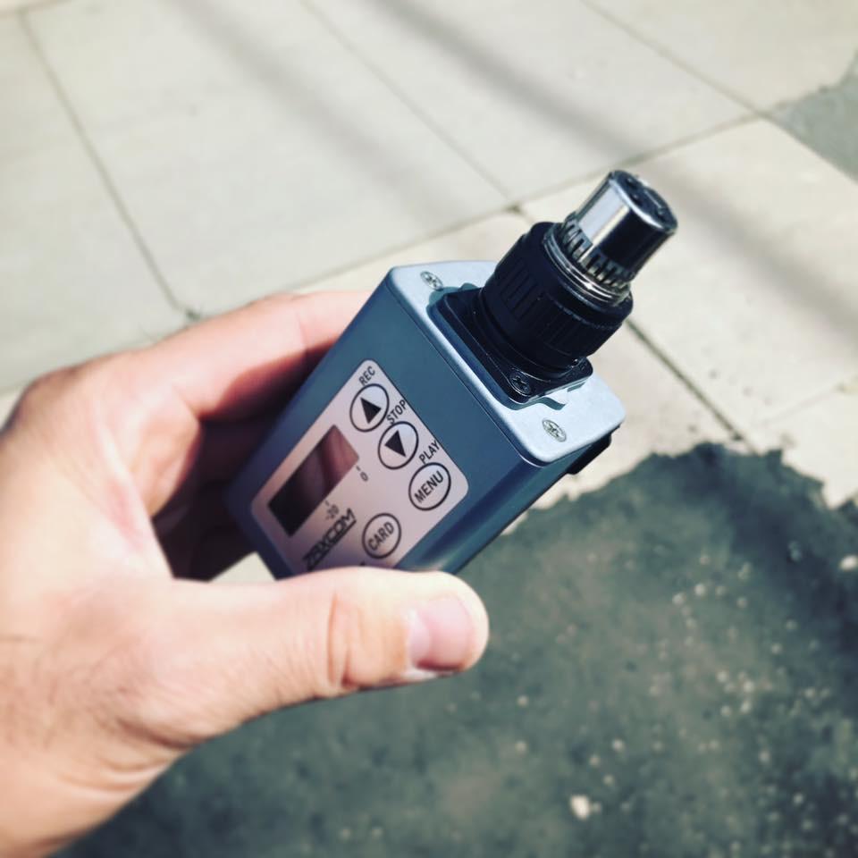

Matthias Richter Posted May 30, 2019 Report Posted May 30, 2019 the SGS needs a holder for every pole / suspension no? My DIY solution converts the ZMT to a self contained plug on. More cost effective... Quote

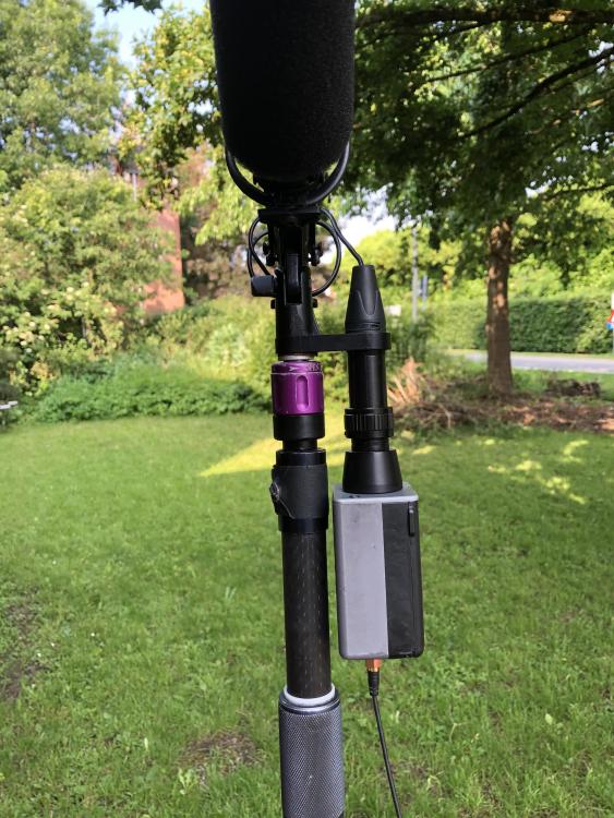

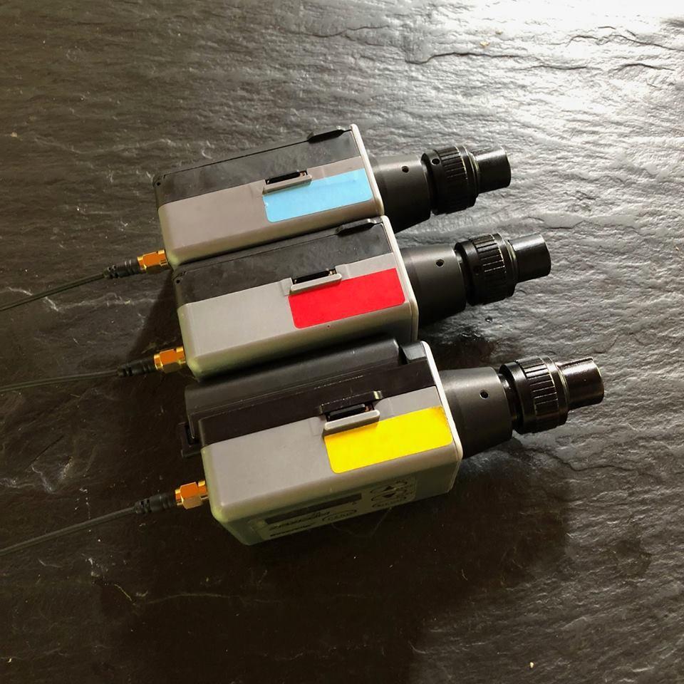

Geluidloopt Posted June 4, 2019 Report Posted June 4, 2019 Neutrik Locking XLR straight onto the mic mount Quote
Tony Johnson Posted June 4, 2019 Author Report Posted June 4, 2019 13 minutes ago, Geluidloopt said: Neutrik Locking XLR straight onto the mic mount They look great what does the other end look like? Quote
Tony Johnson Posted June 4, 2019 Author Report Posted June 4, 2019 classy, i must look at those Quote
Tony Johnson Posted June 4, 2019 Author Report Posted June 4, 2019 13 hours ago, Geluidloopt said: On top of the pole Hi, Do you have the model number of these please/ io cannot find the adapter part on the neutrek website thanks tony Quote
Geluidloopt Posted June 5, 2019 Report Posted June 5, 2019 Hi, The neutrik part is : https://www.neutrik.com/en/product/nc3fx-spec However it screws in a custom ring i built, ie the black cone part in the picture. This allows easy replacement of the connector when it's worn. Quote
