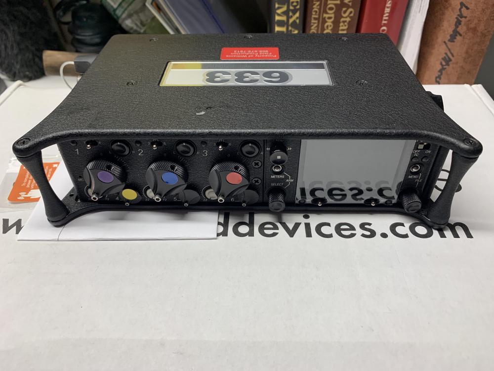

jwill Posted January 8, 2020 Author Report Posted January 8, 2020 She is at the mothership now, SD indicated they would take care of the issue under warranty!! Quote
jwill Posted January 20, 2020 Author Report Posted January 20, 2020 She is back... Replaced return B wire harness, replaced digital module flex cable, replaced lcd cover passed alll factory bench tests, confirmed unit is at production specs!! No charge! Quote
