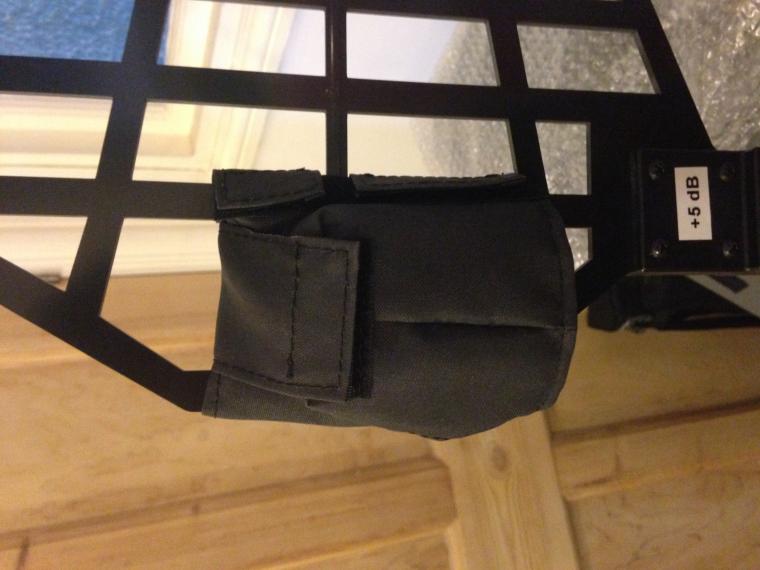

TJW Posted May 9, 2014 Report Posted May 9, 2014 Got the same impression (they provide TC and that's it) BUT the integration of the CL-Wifi plugin for the Beetle unit +Tonmeister app makes me think also they might have concluded an agreement somewhere... KT Systems, Chandler's Ford, UK. I am not suggesting that these will give marine protection but they protect the electronics from the weather without adding windage to the shark fin itself. Tim Quote

TJW Posted May 12, 2014 Report Posted May 12, 2014 Interesting tim. I'd be worried it would absorbs moisture over time if it wasn't dried out but have you got a product name/number and I'll get on to them Have you used them? Sent from my iPhone using Tapatalk They are Cordura so will not absorb moisture. They were only delivered last week so they are dust covers at the moment. In the past we have taped poly bags around the electronics to keep the rain out as bags over the whole shark fin can increase the windage and cause chaos. These should keep most of the rain out of the business end and give some protection. No part number as yet but KT will know what you are talking about if you ask for rain covers for active shark fins. Tim Quote
