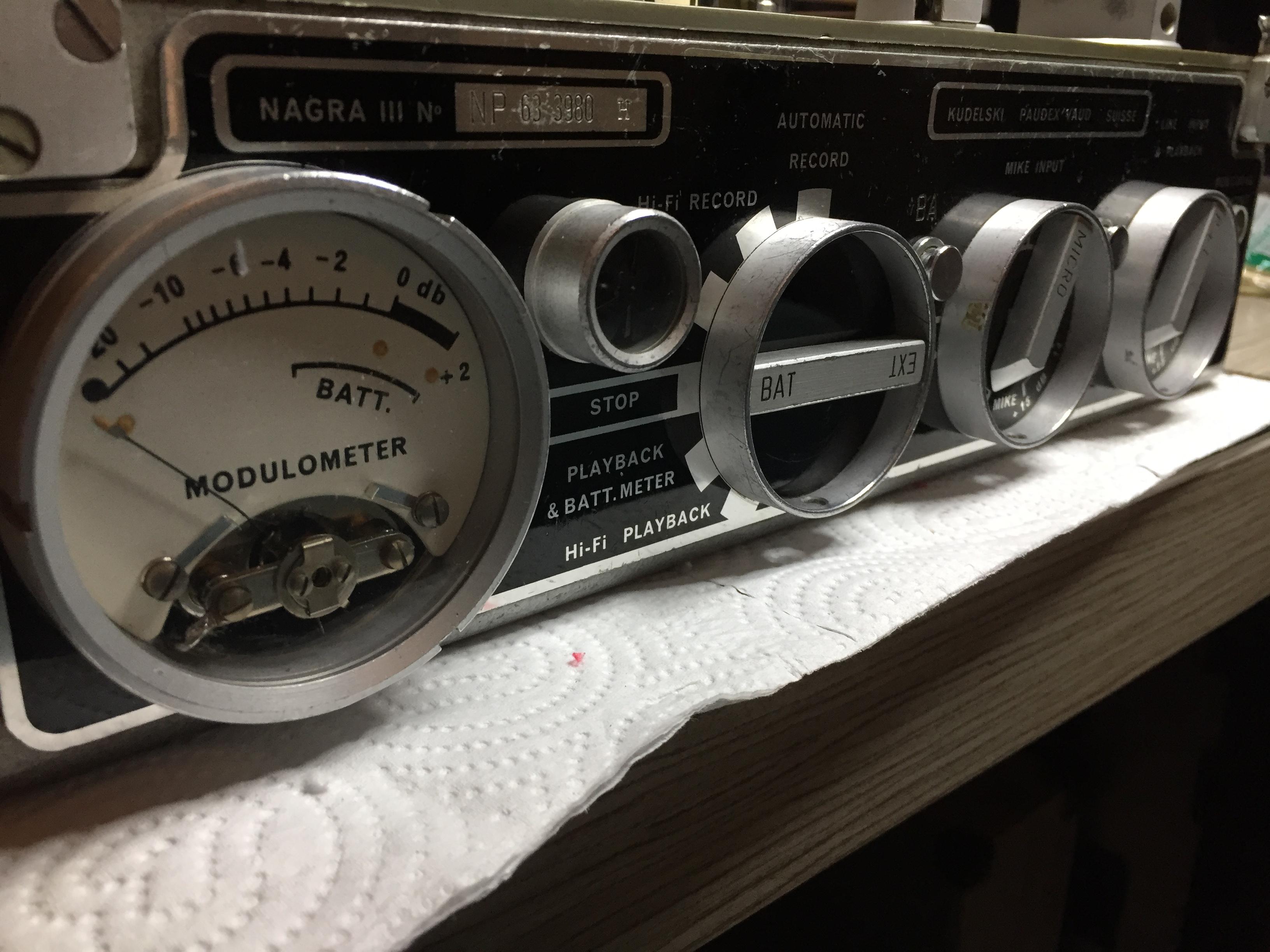

Haggy38 Posted August 10, 2018 Author Report Posted August 10, 2018 Nagra III is home! Finally, it arrived well packed, now inspection and hope it’s working.... Quote
dela Posted August 10, 2018 Report Posted August 10, 2018 It seems to be in a pretty good shape; it will be hard to find a 55 years old piece of equipment that is in mint condition. But the scratches are part of the history... If you are used to seeing "normal" recorders, you will notice that one thing is missing: The flywheel, that normally is necessary for keeping the speed constant and avoid flutter. In the Nagras there is no flywheel, instead Kudelski went all in, and used a powerful DC motor that was electronically controlled by a light weight tacho disc and a sophisticated electronic control system. By keeping the rotating system very light, he avoided having the normal gyro-effect of the heavy flywheel, and that ensured that the Nagra was almost completely insensitive to movement in any direction when recording. You could walk, you could run, you could bump it around, all without variations of speed, and that was essential if you wanted to record on the move. The Nagra IV/4.2 systems were more advanced, but they were in many ways evolutions of the Nagra III, which was a truly revolutionary recorder... Quote

Philip Perkins Posted August 12, 2018 Report Posted August 12, 2018 Looks clean, man, congrats! Fills my heart with nostalgia! The heads are fairly worn but if you aren't going to do a lot of recording on it they'll hold you for a while. But you gotta ditch that 16mm film takeup reel right now--that really make you look like a dweeb! Your III looks like someone took good care of it, I hope it sounds great! Re: summing stereo into mono....best is to actually mix it down in a mixer, but for testing you can just sum the L+R in a combiner cable. This isn't what you'd want to do on an ongoing basis (like for a permanent hookup to your other, stereo, gear), for that you should get some sort of small 2>1 mixer. If you want to stay All-Nagra look for a Nagra BMII, will match the look (and technology) of your III perfectly. Quote

Spectreman Posted August 12, 2018 Report Posted August 12, 2018 Nice reels, but you might want to get a 5 inch take up reel too so you can close the cover if you want. Yes, the film take up reel is a definite no go, especially if the reel is made of steel, which it not good to use with magnetic tapes. Quote
Haggy38 Posted August 12, 2018 Author Report Posted August 12, 2018 Hahahaha I hate that reel already as well, it's wearing plastic 7in and tomorrow arrives the 5in ones, next picture will be better.....promise!! Gustavo Quote
