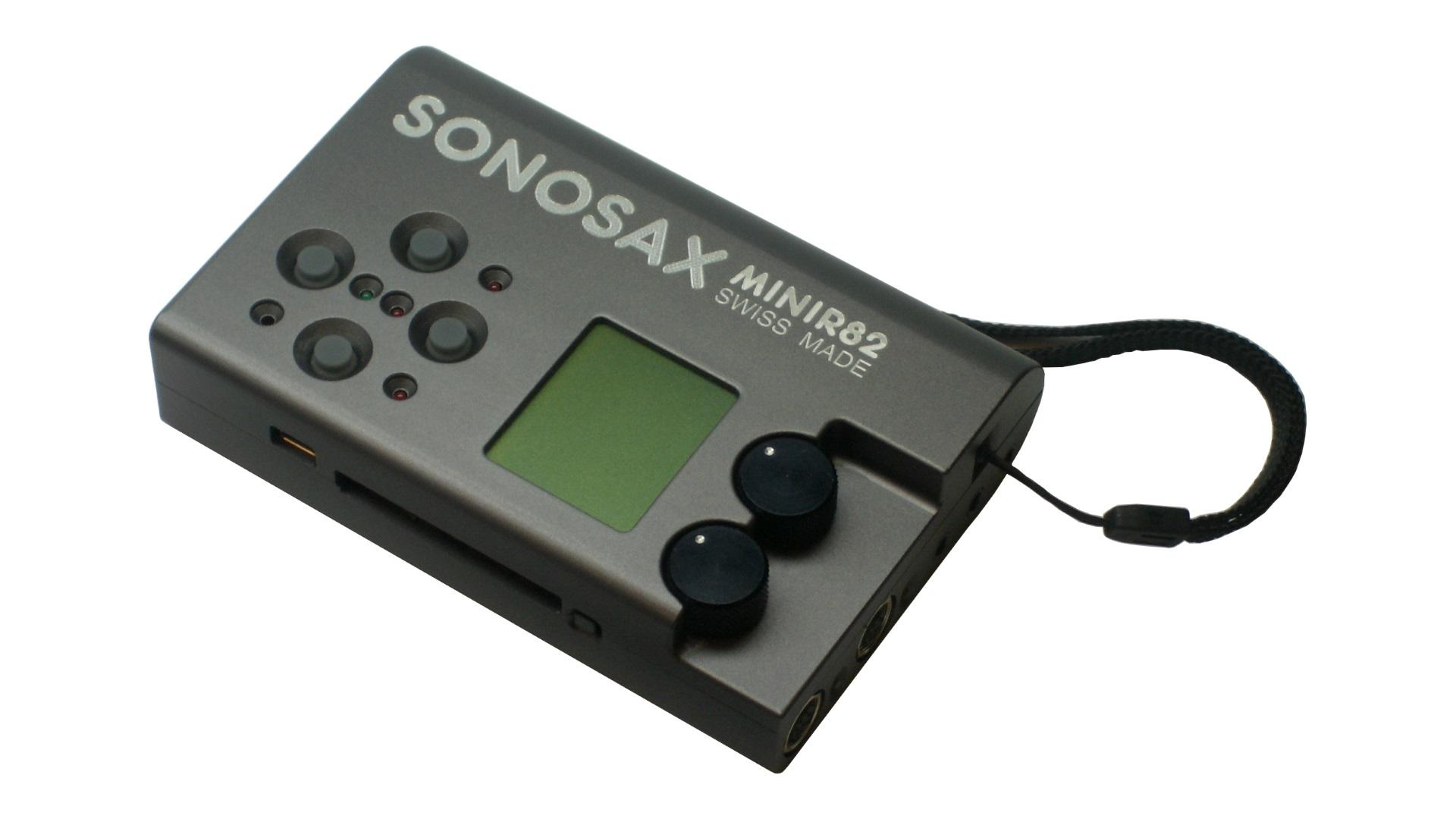

Or a bit bigger, more expensive but 8 track Sonosax:
