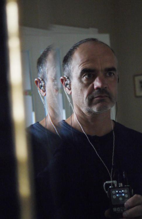

axel Posted November 21, 2019 Report Posted November 21, 2019 lots of uses for PDR and SPDR, some not so conventional: Equipped with a DPA 4098 gooseneck hypercardioid and velcroed to an Alexa Mini, the PDR acts as a preamp/camera mic (Cam has line level input only, but can be fed from the PDR; the gooseneck streches out to the end of the lens. Easy TC jamming for external recording as a backup, ACs could handle it for some remote second unit guide track recording. SPDR acts as a recorder for low profile binaural stereo recordings (nowadays with DPA 6060's attached to the in-ear monitors, with moderate wind an overcover on the mic works fine). I am working on custom made earmuffs for even better wind protection SPDR also grabs high quality stereo recordings from an RSM191, attached to the 191 matrix box which provides power to the mic. SPDR with a proper minijack to 2xTA5 cable records audio from any analogue consumer source with headphones output. Quick/easy/low profile, also for private use SPDR acts as a timecoded stereo backup recorder for your cart or bag system. Caution: as the PDR/SPDR inputs are all unbalanced, there might be grounding issues when the SPDR is sharing external DC powering with other gear Caution: When using the line output of PDR or SPDR as a loop through into other gear, make sure you don't use the dual track -18dB split level option. Or if you must, check the proper wiring of your cables and run a test. See a photo with SPDR and VT500 mics atttached to my UE-4 inear monitors for ambience recording Quote
