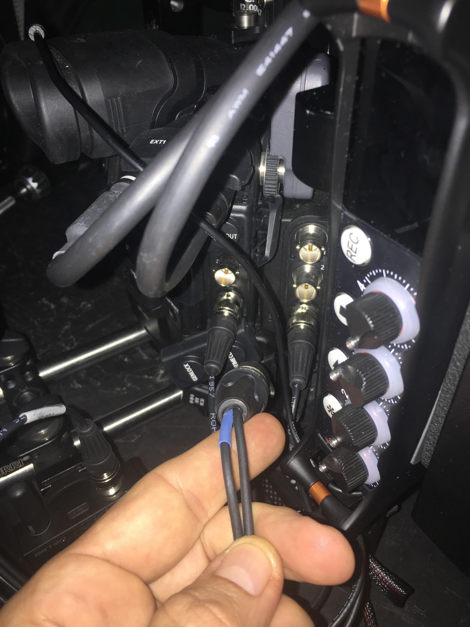

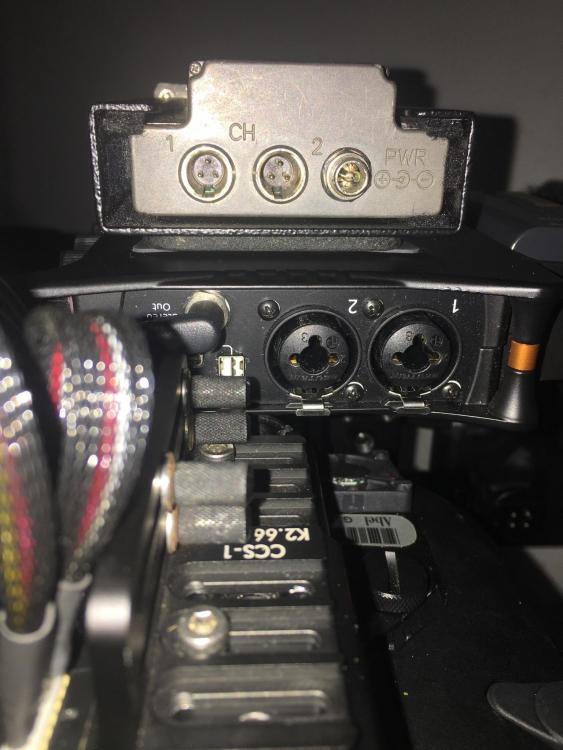

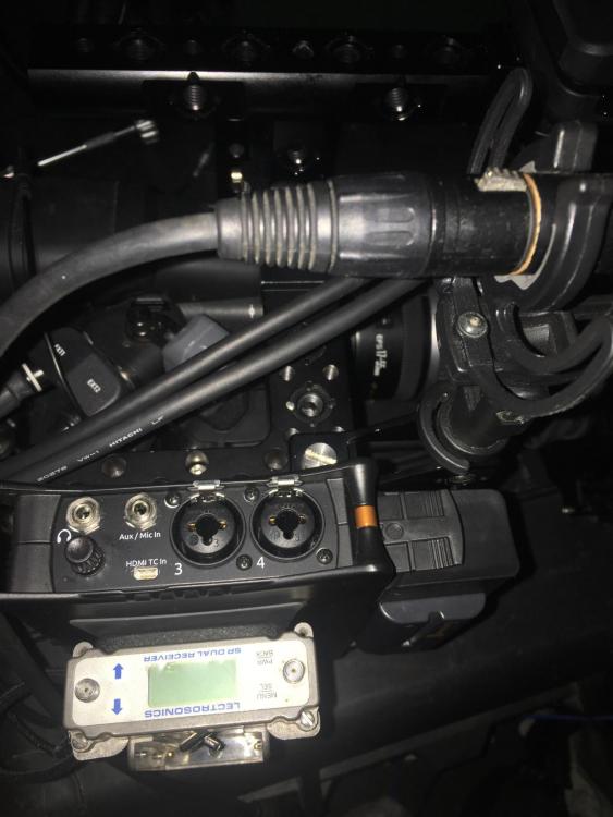

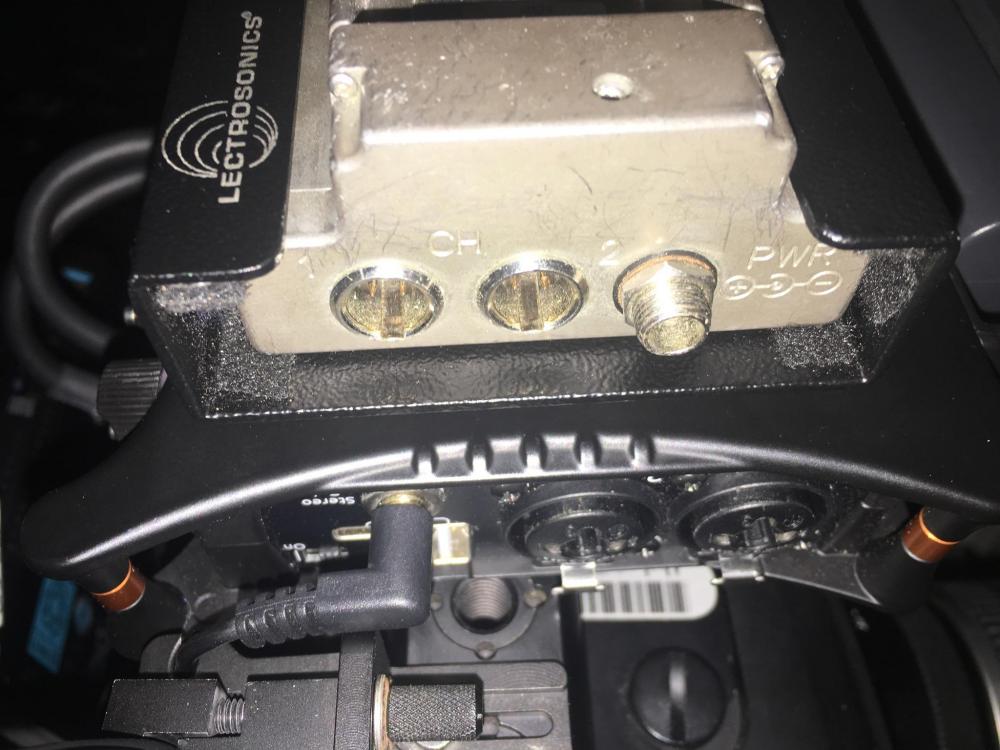

Movies by Matt Posted December 28, 2019 Report Posted December 28, 2019 I'd start here: https://cdn.sounddevices.com/download/guides/MixPreSeries-SonyA7SR.pdf If you went MixPre route I'd imagine you'd feed timecode through HDMI A73---->MixPre3/6, and audio from the MixPre3/6---->A73 via 3.5mm. The question is do you record audio 100% of the time or do you trigger record from the camera? That depends on your project. If it's more verite, I'd record every moment of audio I could (this is the main reason to get an external recorder vs a preamp and recording in camera). If its a sit down interview I might trigger record and I'd work a boom setup if at all possible. Don't settle for leaving your mic on the camera. Soderbergh, when making 'Full Frontal' ,talked about an audience having more patience for poor quality pictures than poor quality sound...or something like that. Learn to operate your camera as quiet as possible so you're not picking up too much of camera operation in your on camera mic set up. Test your IS lenses to see if your mic setup is picking them up. Dial in your kit and cabling so your not fiddling and fighting your kit. A lot of people on DVXUser love those tascam DR10 lav recorders. Yes, you can't monitor it, but when packing and traveling as complete solo production, there are tradeoffs, and if i can lose some weight and kit, therefore streamlining setup and effeciency, it goes a long way. On that note my ideal setup for this exact scenario is 6-8 Audio Ltd. A10's all recording at the transmitter and only 1 A10 receiver with that RX-MON Headphone amplifier on me so I can periodically monitor each recording while I focus on shooting. Give me a Schoeps mini cmit, Sound Devices Mix Pre 6v2 (if i use the 32 bit float 1 time its worth it), Canon 1DX3 (i know its not out yet, but if it has canon log and dpaf, otherwise I'll stick to my 1DC), 100mm macro, 16-35, and a Ronin S. Maybe throw in a Mavic Pro, a Nexto DI NPS-10 and you'd be a doc force to be reckoned with that could all fit into a carry on. Another tip, I always mount my mixpre on the right side of my camera cage (so the mix pre is orientated vertically), then you could use some standard velcro to attach the sony receiver to the bottom of the mix pre, though if you noted my tip before about dialing in your cabling and setup, I'd look into BEC Cases or some other mounting interface for a more rock solid solution than velcro. You do not want to be battling your kit when something important is happening. Last tip, when it comes to cages and mounting, Arri 3/8" with the registration pins is the way to go. Most companies use this pattern these days, Wooden Camera, SmallRig, etc. I abhor a simple 1/4-20 screws from noga arms holding an on camera light etc. as it will inevitably loosen. The one exception to that has been the mixpre, it has a single 1/4-20 but due to the rubber around it, it has never loosened. Thats it for now. Feel free to PM me with any questions you might have. Ugh, one last tip (this is why I’m a lurker and not a poster, too long winded, sheesh, but trying to give a little something back to a great community, thanks again Mr. Jeff Wexler) anyway, with your Sony UWP’s you can go directly into the A73 via a shoe adapter (I’ve read people struggling with levels, etc, I have no experience with this setup, but is something to ponder): https://pro.sony/en_GB/products/uwp-d-accessories/smad-p3 Here’s a few pics of a C500/MixPre/SRa setup (these pics were taken to get some custom cables made, which is why they’re a bit odd angles). All mounted to a cage with my SRa in a BEC case which is screwed onto an adapter that screws into the bottom of the MP6. Quote
IronFilm Posted December 28, 2019 Report Posted December 28, 2019 7 hours ago, Movies by Matt said: 100mm macro, 16-35 You wouldn't bring any focal length between 100mm and 35mm? 7 hours ago, Movies by Matt said: Ugh, one last tip (this is why I’m a lurker and not a poster, too long winded, sheesh, but trying to give a little something back to a great community, thanks again Mr. Jeff Wexler) anyway, with your Sony UWP’s you can go directly into the A73 via a shoe adapter (I’ve read people struggling with levels, etc, I have no experience with this setup, but is something to ponder): https://pro.sony/en_GB/products/uwp-d-accessories/smad-p3 Yes, that is one of the benefits of shooting with Sony wireless (either the new UWP-D21 or the older UWP-D11) is that you can connect it with a Sony camera via its smart shoe You've also got the option of the Sony XLR-K2M / XLR-K1M Panasonic also has one for their GH5/GH5S/S1/S1R/S1H/etc: the Panasonic DMW-XLR1 Quote
