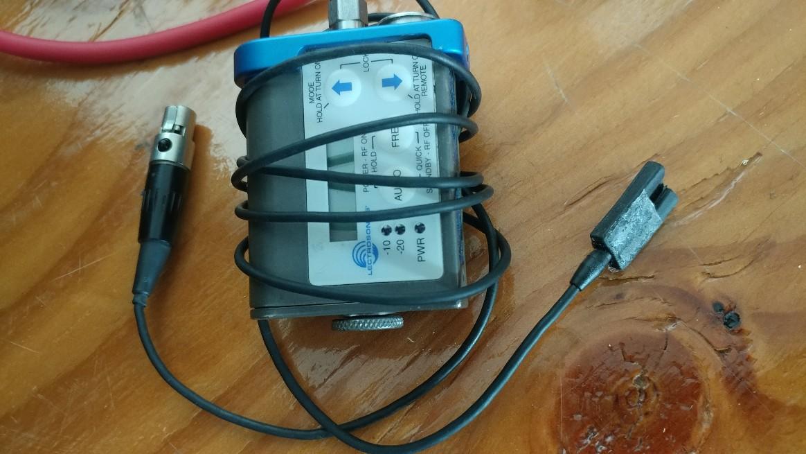

PhilDent Posted March 5, 2020 Report Posted March 5, 2020 22 hours ago, sciproductions said: When miking the trainer how do you deal with shocks from jumping or getting hit etc? I've had good luck with using soft rubber mounts that I wrap in top stick and then tape them just below the collar in the T-shirt with transpore or blendtherm. This works when they strap on the vest and start taking body shots. One challenge is keeping the mic pack from getting crushed by the straps of the vest if I have the transmitter on their waist band. Nothing is perfect and failures are bound to happen. I had one trainer want the pack on his waistband in the front. I obliged not knowing he was going to do body work with the fighter. When he put on the vest the pack was directly behind it and the boxer unknowingly punched right where the pack was and shut it off. It wasn't a good day for the trainer or the transmitter. Quote

PhilDent Posted March 6, 2020 Report Posted March 6, 2020 I use Sanken cos-11 mics. As for the rubber mount, I forget the name of the manufacturer, but it looks like a miniature rm-11. See below. Quote
Blas Kisic Posted March 11, 2020 Report Posted March 11, 2020 On 3/5/2020 at 8:35 PM, PhilDent said: I use Sanken cos-11 mics. As for the rubber mount, I forget the name of the manufacturer, but it looks like a miniature rm-11. See below. I believe that's from LMC BK Quote
