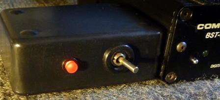

Bob Marts Posted March 17, 2011 Report Posted March 17, 2011 Over the years, there have been occasions where I have turned down my Comtek feed in order to mute it from the listeners between takes, and then forget to turn it back up when we roll. Since there are times when it's appropriate for the sound crew to keep the mics up for our own technical reasons, but at the same time keep the mics muted to the "public", I needed to make myself some kind of reminder to unmute the feed when we roll. I finally built a simple little box that would switch off the Aux send to the transmitter and at the same time, flash a bright red battery-powered LED to signal the muting. Turned out to be very useful. Quote

Bob Marts Posted March 18, 2011 Author Report Posted March 18, 2011 Here's the LED I used. The switch is DPDT - one side to cut the Comtek, the side to apply the power to the blinking LED. The box also held the LED battery. Aux send is routed in and out of the box on it's way to the transmitter. A very easy project for a first time builder. Quote

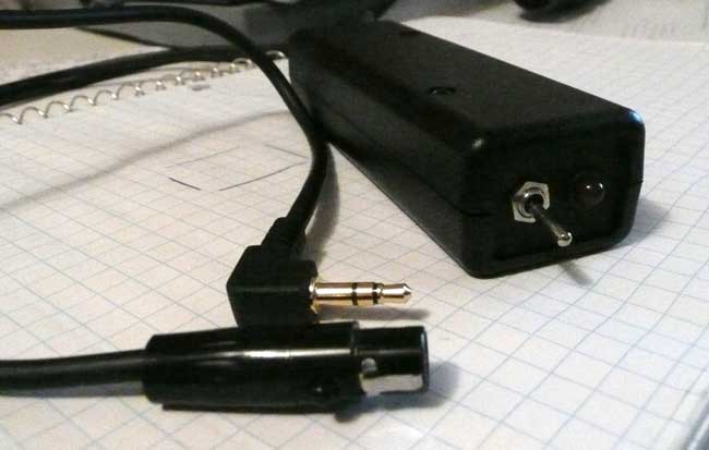

jason porter Posted March 19, 2011 Report Posted March 19, 2011 This is by far the most complex circuit I have made. (still very simple) A red LED blinks once every second until the toggle switch is thrown to unmute the audio feeding a Comtek or any other device. The whole thing runs from 1 AA battery and should last a very long time. Dimensions are 4.25" X 1.25" X 0.75" I also made a different circuit that is much simpler and runs off a 9V battery, if space isn't an issue. It is also easier to adjust the speed of the flashing LED. Thanks for the inspiration Bob, that was a fun one! Quote
