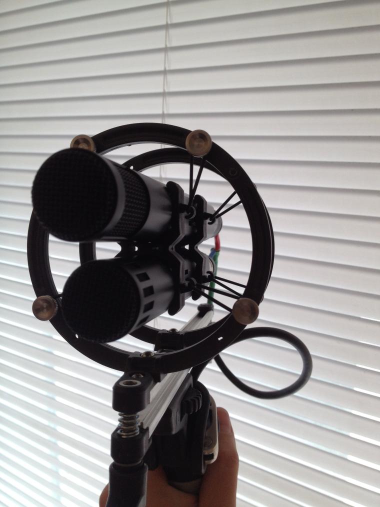

Here's 2 pics of the elastic Rycote stereo mounts on a Rode Blimp with a MKH 50/30 M/S pair. Centering the pair and compensating for front or rear loading can be achieved by using small elastic bands (ordered from Redding from the Rycote catalogue I believe) and moving around the elastic contact posts on the Blimp's mounting rings. This configuration works well for me. Only thing is the Blimp is a bit too long.
I use the Rode setup for my MKH 50/30 MS rig as well and I'm pretty happy with it for ambiance and SFX use. If you get the rycote clips from redding audio for the older rycote suspensions that used rubber bands then the mics can sit centered vertically instead of being justified to the top of the blimp. Also, since the Blimp works well with stereo setups I've sent them some messages about releasing a shorter length main section and gotten no reply. As it's sold, it's longer than ideal for most MS setups and too long for shorter mics but otherwise a decent rig. Maybe we can get them to make a shorter one with some additional feedback from others.
