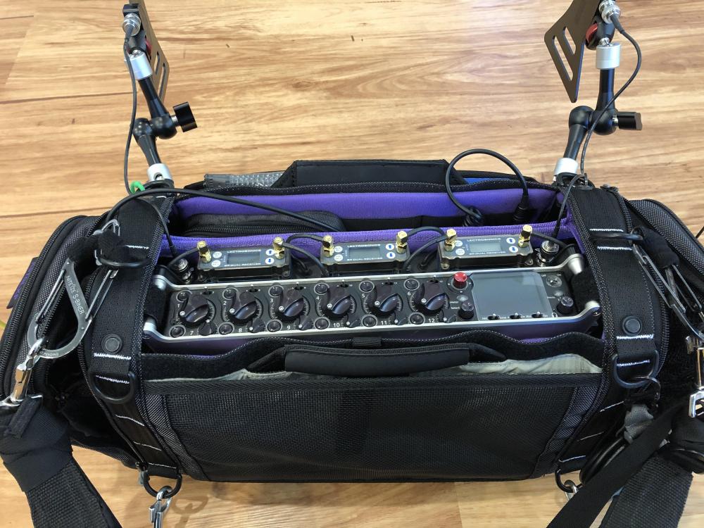

Peter Mega Posted August 13, 2021 Report Posted August 13, 2021 Picked up my large X purple. I was hesitant at the shop when I tried my Scorpio with CL6 in it as it seemed like the straight XLR’s would be strained by the side walls of the bag. I ended up buying it to try out and in the end I hooked everything up and if I leave the sides open a bit, the XLR’s are not really getting strained. If the sides were zipped up all the way, the XLR would be strained a bit. I’ll leave the back side zips down pretty much all the way with the front side zipped up to the top edge of the bag which seems to be good. Will allow for ventilation as well. Cam link is in the right outer most pocket. IFB tx on the left outermost pocket. Only gravity holding them in at the stage. Will look into a better solution for securing a bit better. Access to SD cards and time code connector is easy. Antenna attachments on the front are very handy. Headphones in the mesh pocket on the inside left. I’ll probably tweak where I have the NP1/cup and the spare NP1 as it’s in the front pocket at the moment. Will see how it goes where it is. I don’t like burying the NP1 deep into the bags to allow for quick battery changes. I might try some shorter articulated arms for the antenna at some point or go back to the little mounts that came with the bow ties. Bag is very well made as is everything from K Tek. It’s a lot more compact than the Orca OR334 I was using. I’ll probably sell the OR334 if anyone is interested. Yet to try on a gig. Looking forward to it. Cheers. Quote

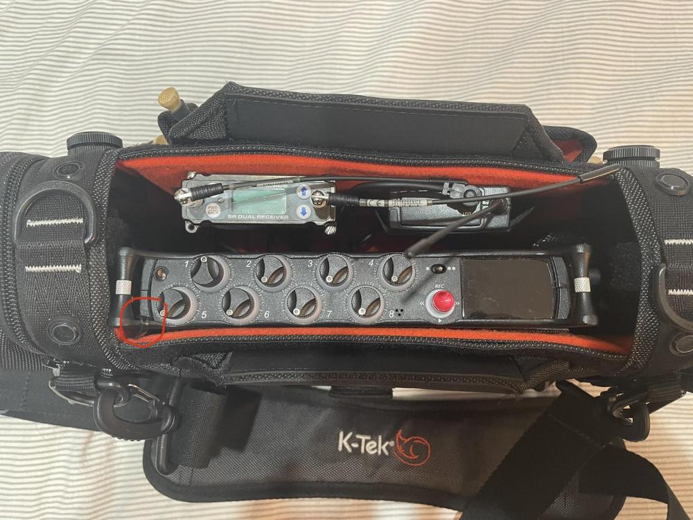

Ian Berman Posted October 19, 2021 Report Posted October 19, 2021 On 8/13/2021 at 7:36 PM, Ian Berman said: Yeah, the sagging away from body thing happens to me with my MP10 and Stingray Junior X. I just velcro the MP10 to the bottom side of the bag directly, and don't use the velcro loops, since they're fastened in the middle of the bag, not the bottom. I have my wireless receivers at the top side of the main compartment so hanging the MP10 in the middle of the compartment would be odd. The MP10 mostly sticks to the bag in the middle area but doesn't quite hold onto the velcro on the sides, as it curves outwards against my body. It's a little annoying, but it's still very securely held by the velcro. If anyone has an idea of how to improve the rigidity of the bag (to keep it rectangular rather than bending out against my body), it would solve a minor annoyance... FWIW I've found that having both wireless pouches filled at the top side of the bag helps with rigidity for whatever reason, so even if I only need one or two wires I keep an extra receiver up there, rather than having an SRc on one side or the other and taking the other one out to save weight. Update, I zip tied one corner of the mixpre 10 to the frame of my ktek bag (it's internally accessible without going thru any zippers). Seems to help with making the bag more rigid, and it no longer sags against my body in the same way. Quote
