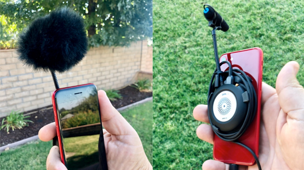

Shastapete Posted June 4, 2021 Report Posted June 4, 2021 The "Gold standard" would be a DPA mma-a and 4097 ' https://www.dpamicrophones.com/news/gene-martin-calls-on-dpa-4097-micro-shotgun-for-sales,-rentals-and-field-production Or for a 1/10th of the price you could look at something like Shure MV88 Quote

James Louis Posted November 5, 2021 Report Posted November 5, 2021 If you look carefully in that DPA article, it appears as though the mma-a is fitted with a rubber binding with three overhang segments holding it to the fixture. See that? Any idea where I could get one? I tried the general comments, questions submission on DPA but haven’t heard from anyone. Do you have someone you reach out to? as for laptops and phones, I have been using snot tape; I keep a rolled up end which I’ve scored with a knife in the same kit. But I also have the interview kit, and with their announcements on the heels of eachother, it has been my assumption that the plastic plate with Velcro fasteners would be suited both for body packs but also perhaps for the mma-a. It isn’t. With something disk shaped, coupled with connectors out the edge, I’m hesitant to use ties (it will always fit snug to the widest dimensions, the circumference). And I think tape is not suited for that kind of movement, being upside down etc… any suggestions? Quote
Barry M Posted November 5, 2021 Report Posted November 5, 2021 Ask Gene Martin at Audio Dept/Sound Guys Solutions? That MMA-A mount (and maybe a couple of the other bits) look 3D printed, I think? Might've been his prototypes. Quote

James Louis Posted November 21, 2021 Report Posted November 21, 2021 @borjamyet another reason why I think the mma-a got squeezed out. You pay about as much as a mixpre3, and if you get the 3ii there’s 32-bit, noise assist, recording, backup, routing etc… i will say this, it’s very tiny. About the size of 3-4 poker chips in a stack. It can drive their little mics, and you could handle everything on a pole. That and genuinely good AD converters. Quote
