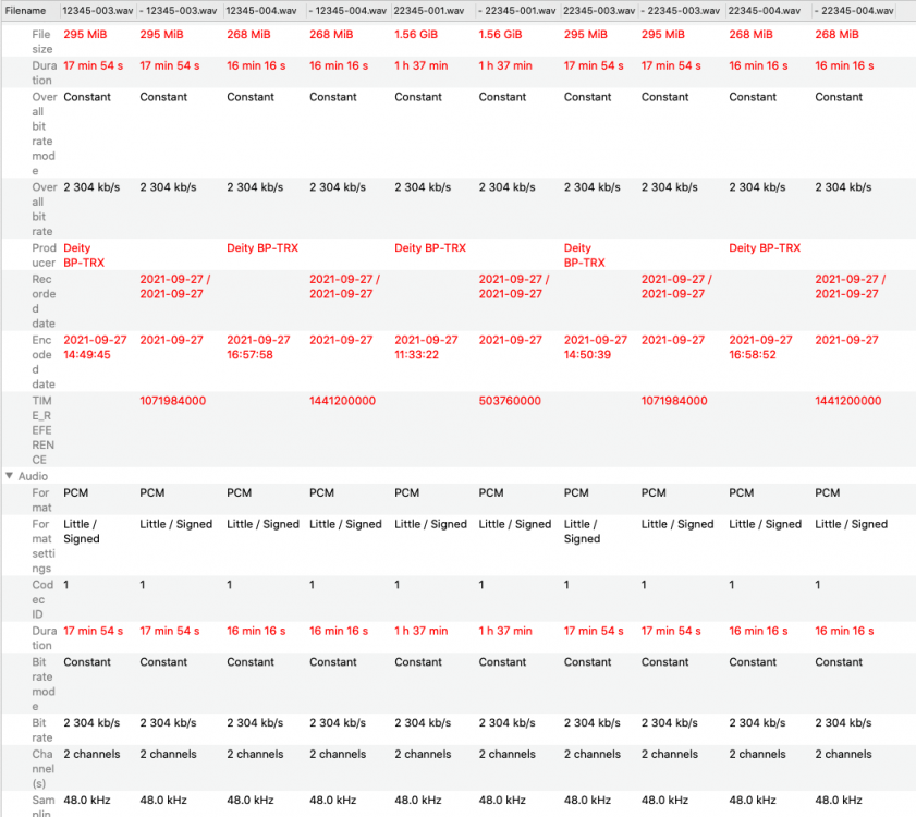

Bouke Posted September 29, 2021 Report Posted September 29, 2021 What happened on these files: The file size in the header was set to x00 00 00 00 (Read, zero.) Same goes for the size of the Data chunk. (As I expected.) This makes sense after a crash. The device expected a normal exit, then measure the file, then set the correct values. It's absolutely no problem to fix these files 'in place'. (If I find a bit of time today I'll build it in 'somewhere'.) The drift is something else. There is a normal BWF timestamp. Perhaps, but that's a VERY wild guess, that gets altered to a NDF format or alike on normal exit. (Where the normal clock runs in RT or so.) No matter what the trouble is, I bet it's a DF / NDF (0.1 % or 3.6 seconds per hour) drift. That's a golden oldie, also easy to fix. Quote

Bouke Posted September 30, 2021 Report Posted September 30, 2021 On 9/29/2021 at 8:34 AM, Sound said: Is seems like DF / NDF from the delay you are talking about.. Although I am recording in 25p, so there should be no DF or NDF... Nope, then I have no clue... But I don't know how these thingies are working... How big is the drift, is it constant? Does the drift get bigger when the TC values increase? If so, by how much? Quote
Sound Posted September 30, 2021 Author Report Posted September 30, 2021 Yes, its no offset or delay, its a costant drift. So its getting bigger when TC values increase. When I dial in the starting timecode manually, the first minutes are i sing. Im not sure, but I had a few seconds drift after some time.. I guess after one or two hours.. Still after almost four days testing, I guess the problem only occurs when triggering the recording remotely. Maybe the solution would just be to map the shortcut on the device to put them to sleep mode instead of start and stop record... And I think it only occured after the first FW-updates.. Quote

Bouke Posted October 2, 2021 Report Posted October 2, 2021 Please, make it simple. Give me a few (at least two) timecodes (Or bwf timestamps) with the corresponding drift, and I know what I'm talking about. Quote

Bouke Posted October 3, 2021 Report Posted October 3, 2021 16 hours ago, Bouke said: Give me a few (at least two) timecodes (Or bwf timestamps) with the corresponding drift, and I know what I'm talking about. On re-reading, it should say: THEN I know what I'm talking about. (At this point I have no clue what could cause drift, the Deity guys should know. I'll rant about that in my next post.) Quote
Rick Reineke Posted October 3, 2021 Report Posted October 3, 2021 A mismatched sample rate between the file and DAW will cause drift, especially on long takes, and it is not as easy to detect a slight speed/pitch change with dialog. Timecode alone does not guarantee drift-free sync either, even if both the file and the DAW are the same sample rate. Quote
Sound Posted October 3, 2021 Author Report Posted October 3, 2021 Its all 48 kHz 58 minutes ago, Rick Reineke said: A mismatched sample rate between the file and DAW will cause drift, especially on long takes, and it is not as easy to detect a slight speed/pitch change with dialog. Timecode alone does not guarantee drift-free sync either, even if both the file and the DAW are the same sample rate. Quote
Bouke Posted October 3, 2021 Report Posted October 3, 2021 for fixing corrupt / bad files: https://www.videotoolshed.com/product/wavefix/ Deity should have made this though, not me. I can / will add more functionalty to taste, Quote
Sound Posted October 3, 2021 Author Report Posted October 3, 2021 54 minutes ago, Bouke said: for fixing corrupt / bad files: https://www.videotoolshed.com/product/wavefix/ Deity should have made this though, not me. I can / will add more functionalty to taste, Thanks Bouke, thats a quick fix! It seems to work! I was wondering where the fixed files are, as they are not in the selected "storage location". But then i saw that it fixed the originals. (Maybe it would be even better to add anoter option not to overwrite the originals) I could check for the audio delay now. And I must say I have been wrong: It seems to be a fixed timecode offset. For some reason all the rescued files are almost exactly one second off, which means the recorded audio in the bp-trx is one second too soon. I dont know why that happens, but it can be fixed quite easily if i add a +1 second offset when syncing. Its always the same offset, no matter if i rescue with your app or with reaper. Sorry for the wrong information, guess I was too tired the night I found out about the problem and tried to fix it.. Quote
