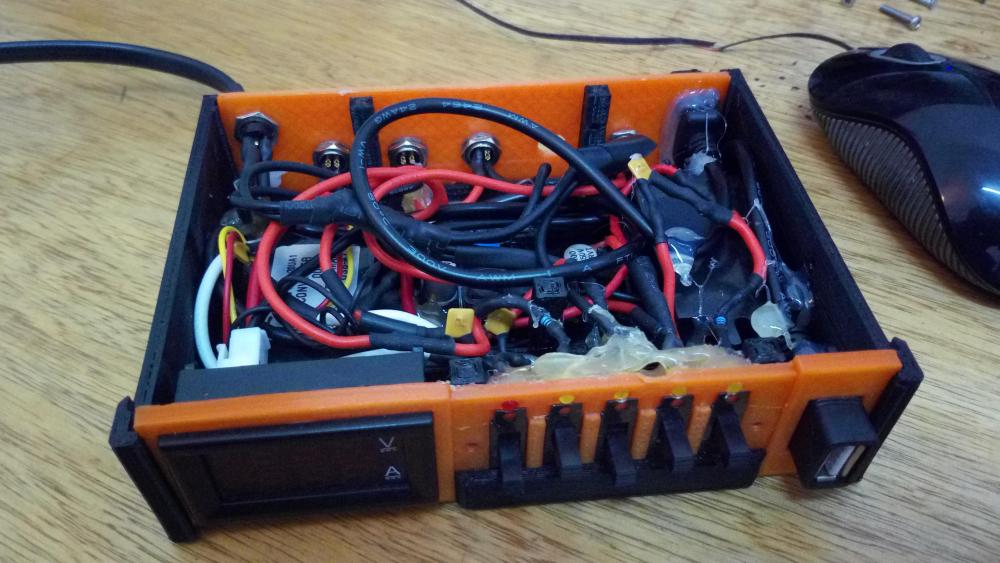

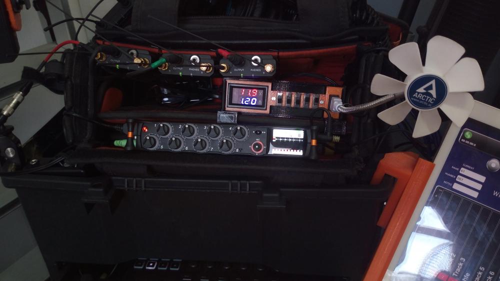

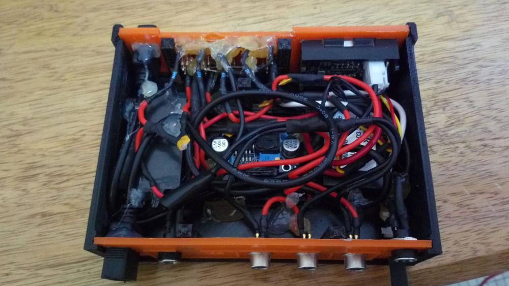

Hi, Here is my DIY BDS. It has 5 switches which are wired like this : 1) Master switch : activate all the other switches + voltage/current display + back usb output (to charge tablet/phone for wingman) 2) one Hirose for recorder 3) two Hirose for wireless mic and IFB 4) One hirose + one DC jack for video monitors and other stuff 5) One USB output (for a small light or a fan : I live in west Africa) It has 2 inputs : -1 hirose -1 dc jack I am mainly using modded Talentcell battery, so I can use and charge the battery at the same time. The voltage is regulated at 12V. Each output is protected by a fuse so as the master. Each USB is capable of delivering 5V/3A. Each switch has a led to see if it’s on or off. The case has been (badly…) 3D printed in PETG. It works very well. A little big but works well ! The power consumption display is really usefulll ! Side notes Power consumption tests of the recorders I have, with all channels activated (mic level for all and one with phantom power) with nothing plugged in : 1) Zoom F4 : 0,25A 2) SD 702T : 0,72A 3) SD Mixer-10T : 0,65A

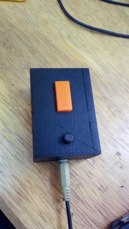

Hi, The SD MixPre-10t is a great machine, but I missed a mic to talk with the boomop. As the inputs 9-10 can provide pip, I built a small talkback box. I used one of the stock microphone I got with sony uwp d-11 (I am using Sanken cos-11), a switch I got from an old cheap solder iron and a 3d printer. It is pluged on inupt 9. It works well, I haven't tried it in a live situation yet. It is then sent on output 2 with the boom to the boomop. On the downside : - you can't send input 9 or 10 in prefader mode (as there's no fader for it), so I have to route it on the right channel. It means I can't send anything else on the right channel and my mix has to be on the left channel only (booms + lavs ; usually, I send booms on left, and lavs on right). It is not a big issue as post will be done with isos most probably but still, I would love to have the possibility to send inputs 9 and 10 prefade. -there's a "pop" when pressing and releasing the switch. I guess a capacitor could help but my electronic knowledge is not good enough to work on this without the fear to break something in the mixpre. Hoping it could inspire some people...
